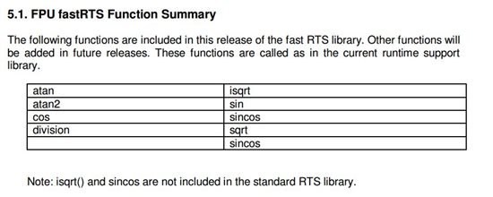

    1/ CLA is a hardware module on chip as FPU. It run parallel with chip. CLAmath only support for chip have CLA module.
    Very true
    2/ FPUfastRTU is a lookup table  and only support sin, cos function.
    Yup, here's a complete list:
