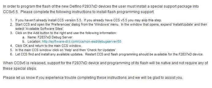

I have CCSV5.5.0.00077 . I've bought a Delfino 28377 Control card. I'd like to know what patches I need to add to use it and also to use with Spectrum Digital JTAG XDS 510 and where can I find the pathes.
