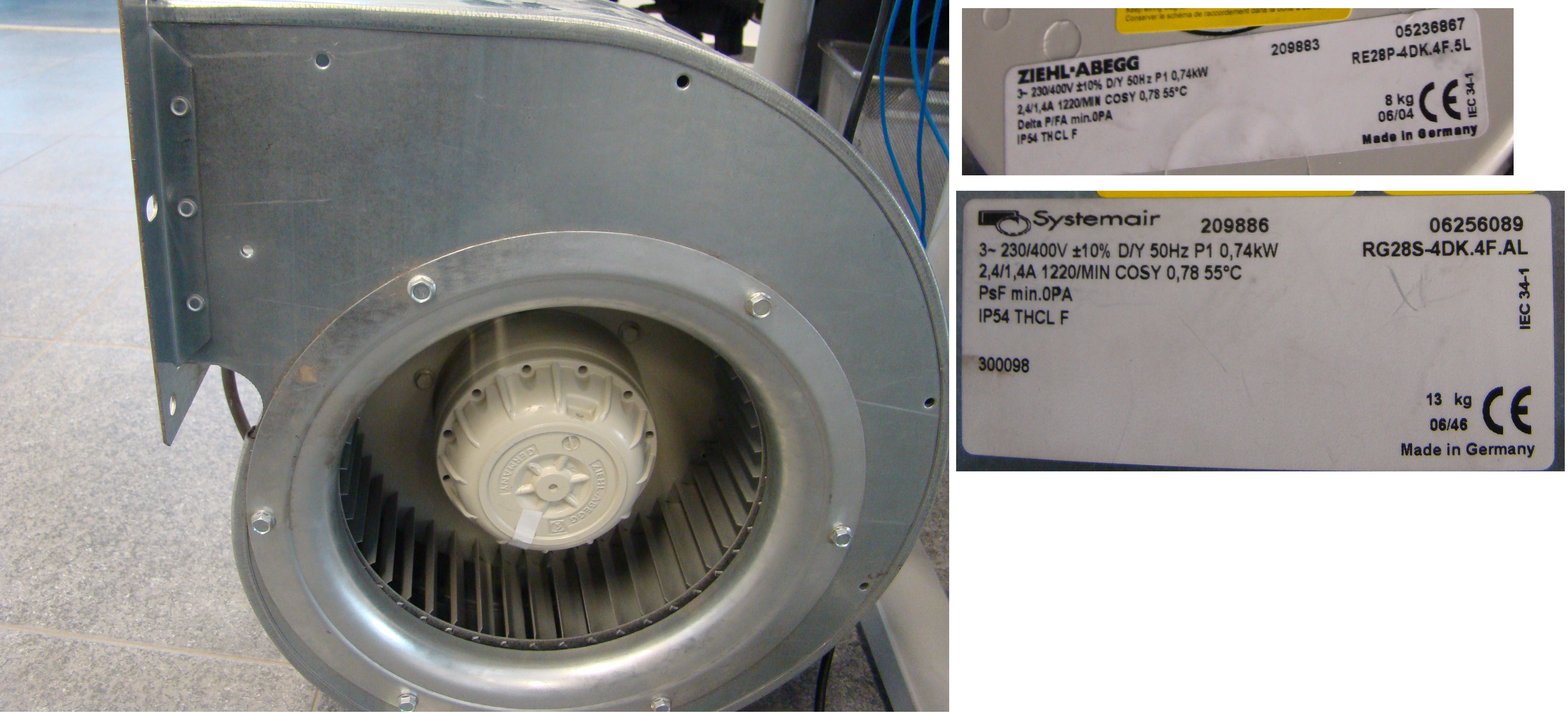

I tested Motorware 12 Project Lab 2b to identify my motor (0.74kW) using TMDSHVMTRINSPIN and F28027F ControlCard (and the compiler is 6.2.3 under CCS 5.5).
I give you the screenshot of my motor below.
We don't know how many poles this motor has, also there is no other parameter besides the ones in the plate. So I assumed this motor has 2 pole pairs.

  • Hello Maria,
    I actually know a bit about this motor, or one quite similar.
    First I would suggest you try to dismount the motor from the turbine.  This turbine (and many fan applications) have quite a bit of inertia that makes it very challenging to keep stability and get good values during motor ID.  It is quite a strange, heavy, and oscillating load, even at low speeds.  Also, many of these motors have very long wires for installation and this can cause an issue.  I recommend shortening the wires for initial evaluation until you get closer to having things well understood.
    Finally, once ID'd and running with no load, only then add back into the turbine/fan system.  Then, you get to have fun with your speed controller :)  If ever in doubt, SpinTAC controller in InstaSPIN-MOTION handles these types of high inertia, variable loading applications like these fans quite well :)

  • Hello Chris and all,
    This is the ID result after the motor is dismounted (we removed the rotating cage of the motor).
    Seems no changing on Rs but Rr is definitely changed. Ls becomes a little bigger. Im and Flux are also bigger.

    We checked again the motor connection, it was connected to star (400V), our mistake to not double check this connection.
    Then we changed the motor connection into delta (230V). And run Project Lab 2b.
    The result is totally different that you can see below:
