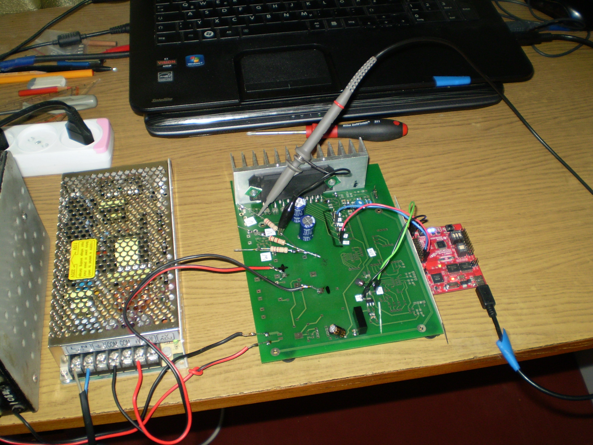

    No, I don’t use all these “hundred dollars” kits from TI.If you buy one ,then you must be afraid that you will burn it or destroy somehow.
    Instead, I built simple setup based on IRAM136-3063B module.You can see it on the attached photo.External bootstrap caps on the module are 2uF each.
    This simple setup I connect now to “normal” LaunchPad with TMS320F28027PTT on it.
    I learn Structure of the system and C functions of InstaSPIN. Even with this simple cheap setup many things are possible.

  • Andrey,
    Granted our BOOSTXL-DRV8301 is only 24V/10A while you are using a 600V IR driver, but they are both the same price, $49.  Our Boost also includes direct connection to the LaunchPad and of course 10s of software projects with all drivers and libraries ready to use immediately.
    Probably most importantly the layout of the inverter and current sense has been optimized for excellent performance.  I really have to wonder how good your signals are and what sort of control capability you can test.
    Just food for thought.
