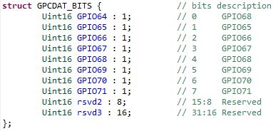

I have some doubts about the concerto F28M36 GPIO documentation (SPRUHE8B).
In section 4.2.7.40 bits 0-3 of GPCDAT register are marked as "Reserved". The problem is, I have not found the DATA bits of GPIO from 64 to 67.
If we follow the numbering logic it should be placed in GPCDAT bit 0 to 3.
It tried to write in these bits and I can't change the GPIO64 logic level on the Experiment Kit.
I think it is a problem in the documentation, but is there someone from TI that can confirm that point?
Dimitri
  • Dimitri,
    It looks like you are correct.  The header file and documentation will need to be updated.  I will contact the appropriate people to get this corrected.
    For now you can make the following edit to the header file (F28M36x_Gpio.h) to gain access to the GPIOs:
    From:
    To:
    Hope this helps!
