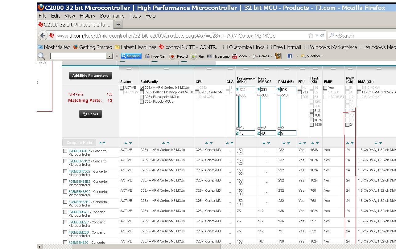

shows all the concerto devices have 24 channel pwm.
The data sheet.shows, F28M35 has 18 pwm channels.

this is because it is counting the eCAP (which can outpt PWM) as a PWM channel.
18 + 6 = 24
F28M35 has 24 pwm channels(18 pwm channels and 6 eCAP (counted as PWM))
F28M36 has 24 pwm channels (24 pwm channels and 6 eCAP (not counted as PWM))

Hmmm. Thanks, we should be consistent on how we tally our features. We'll get this fixed.
