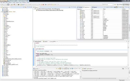

  • We fiddled with the EST_FREQ, and IND_CURRENT and no luck still.
    The values returned are not valid to drive the motor. The motor spins with lots of noise and barely.
    With our design values set in user.h the motor spins better when running lab04 but not satisfactorily.

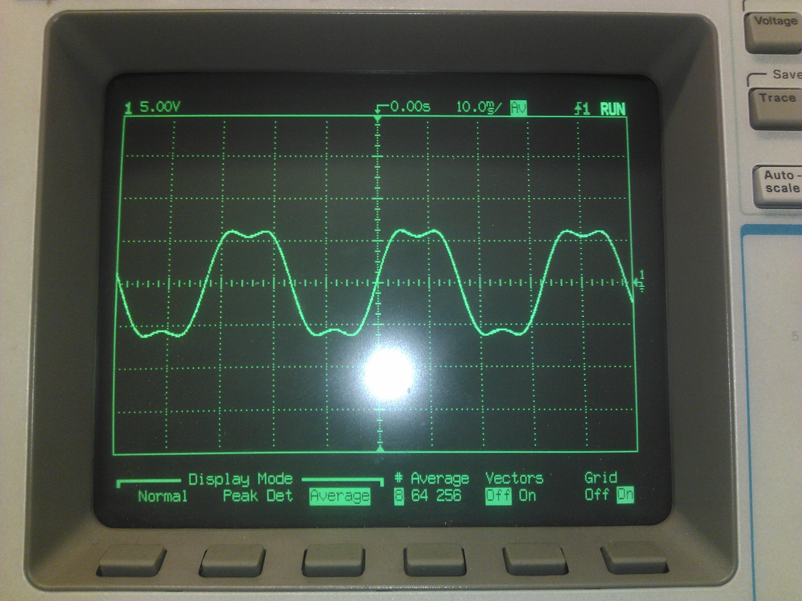

    We also checked the waveform that was going to the motor and it was terribly noisy. Something is not good.
    We also doubt of the quality of the build of the motor, because when we check the waveform of the motor as a generator the sinusoidal is slightly clipped like below. Do you think this is a critical flaw?

    If your motor is damaged all bets are off...Your waveforms look like a true BLDC motor (which is rare, but certainly possible).  InstaSPIN-FOC works just fine on these motors, it just drives them with sinusoidal waveforms so you lose a bit of torque efficiency.

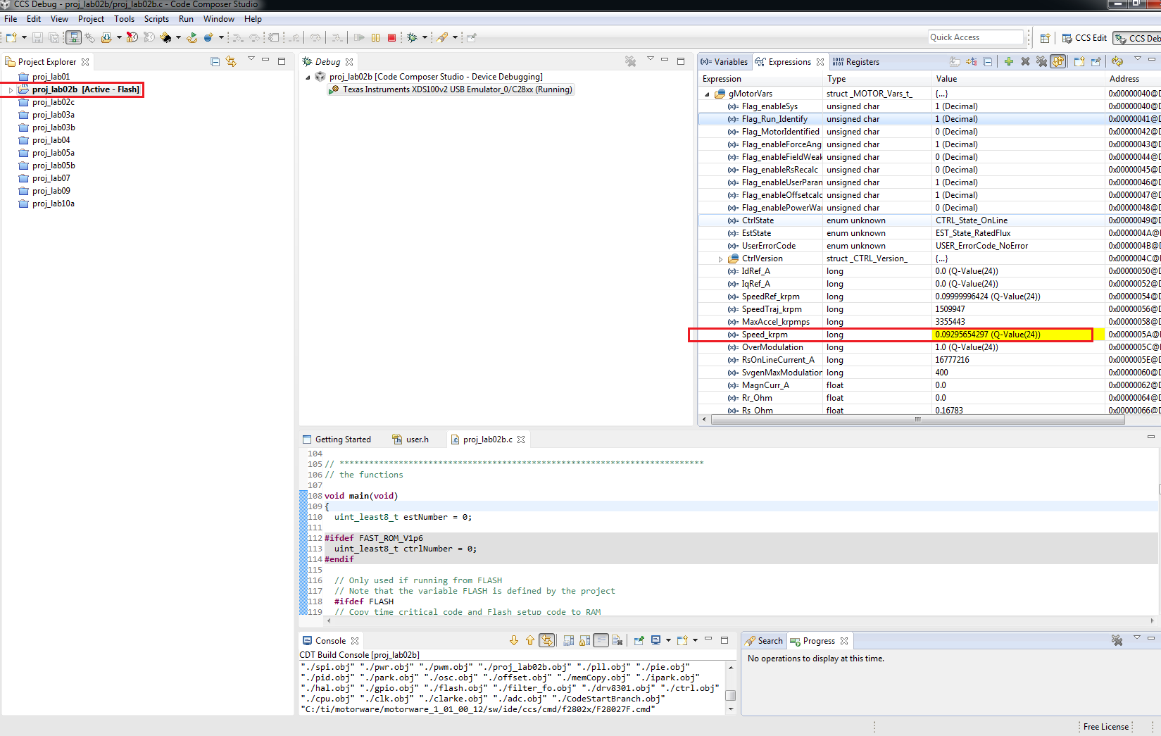

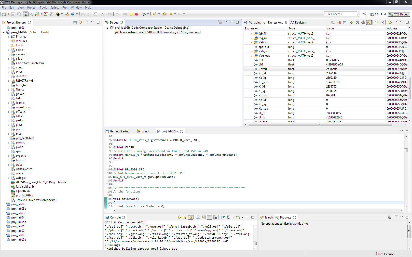

  • 1. is the motor just in the middle, or are all those wires part of an outer stator?  If the motor is just the middle portion disconnect everythign from the shaft to do ID.
    2. when you start ID please report this variable in Expressions View: ctrl.RoverL
    Does it hit 2000.0?  Does it go negative?
    3. If it goes negative try using #define USER_R_OVER_L_EST_FREQ_Hz (300.0) in your user.h
    4. make sure you are using proj_lab02c
  • It does hit more than 2000 but it does not go negative, meaning no iq_ overflow I guess.
    The identification surely does not get accurate values. We have followed the procedures described in http://cache.freescale.com/files/microcontrollers/doc/app_note/AN4680.pdf to obtain the the Ls_q and Ls_d manually. Specifically we got 53E-6 H. Then, we have tried to set the Ls_d and q of the motor in the user.h for lab05a. Again USER_ErrorCode_ctrlFreq_Hz_Low pops up. We have commented out the part of the code that checks the error so that we can run. The motor runs and if we adjust the current coefficients we get somewhat better results in terms of error between measured current and set iqref.
    The motor is slightly smoother if I try to arrange the PI gains according to TI documentation. We have set the Ki_iq to R/L = 0.12/53.3E-6 = 2250. When I put this value, the Ki_iq just overflows, goes negative and everything stops working. Do you think that its the problem?
     The error between the iqref set and the actual measured output is quite different. Do you think it is a coefficients problem?

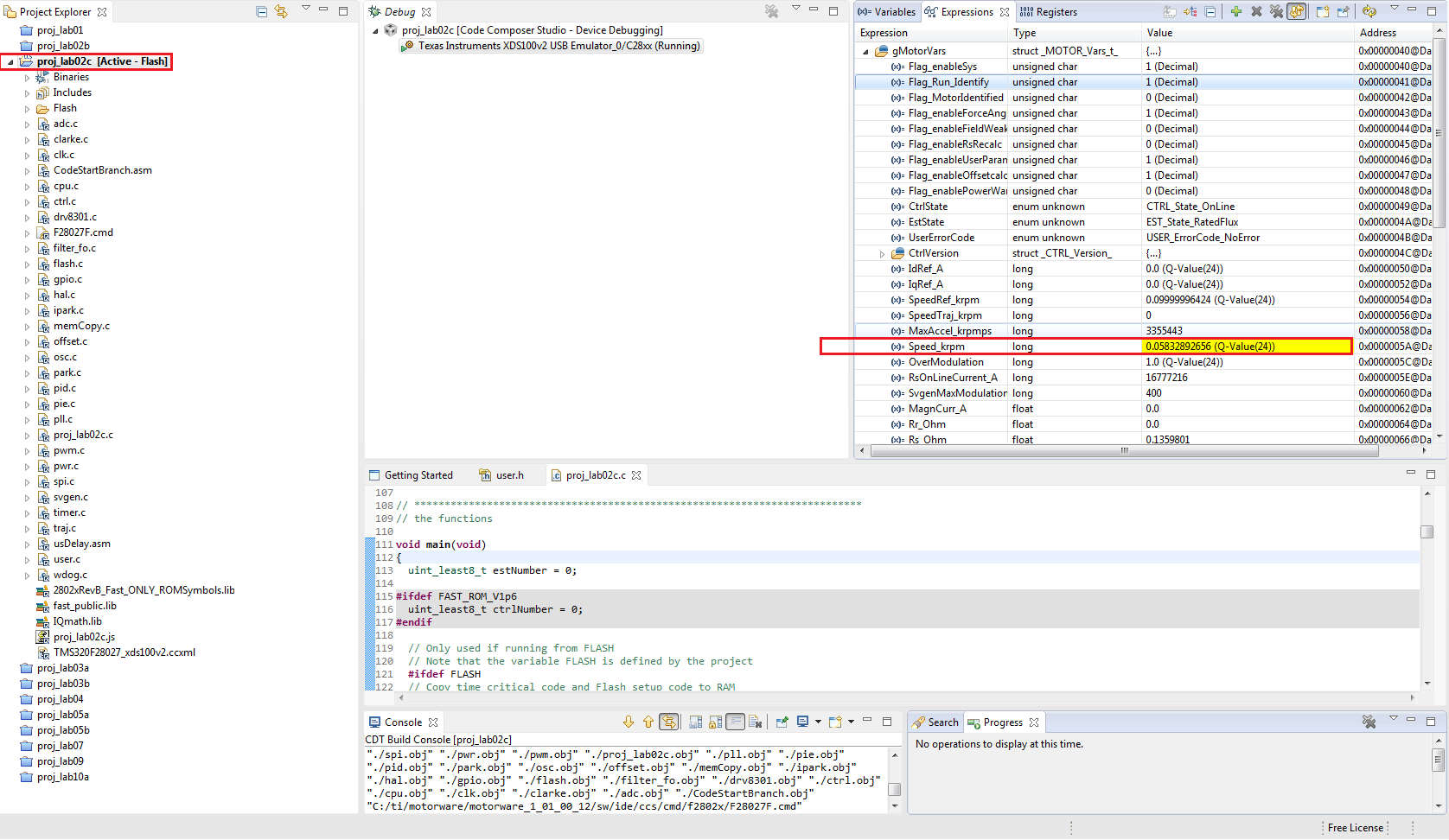

  • Paulo,
    use proj_lab02c to ID the motor, this is required for the low Ls motor you obvioulsy have.
    You obviously have changed something else in user.h
    If your Ls is 56uH that's fine, use (0.000056).  You should not get errors if the rest of user.h is set correctly. If you get an error you can look in user.c to understand what variable might have caused this. Ex:

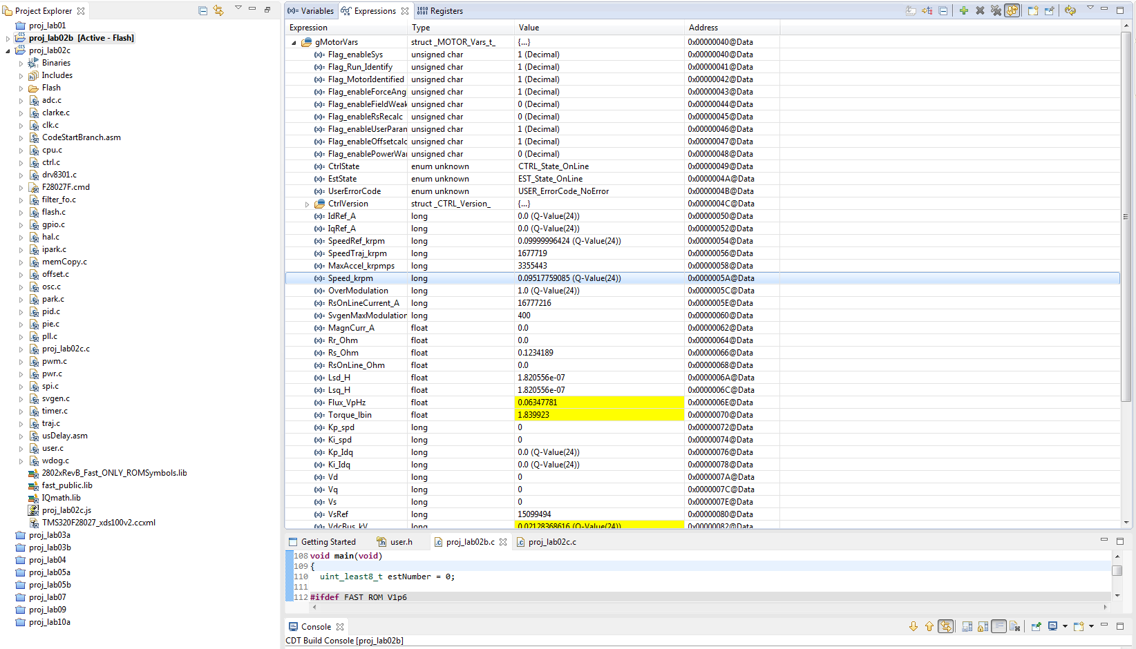

  • We managed to find our big problem by now. We're using version 5.5 of CSS without noticing all the compatibility problems.
    After installing version 6 we got a successful Motor ID and the sound of motor running seems now really smother and healthy.
    We got some more questions:
    1. The torque value is floating from negative ranges to something around 20.  Can you help us debugging this particular variable?
    2. Can we get feedback of the AC current and voltage passing through the phases?
    3. Is it normal to expect current decreasing while applying some load on the motor?

  • My guess is you never updated your compiler to 6.2.3+ in CCSv5.5.  Moving to CCSv6 had compiler 6.2.5 default which is probably what solved your problems.
    I've actually never used CCSv6....guess I should give it a try :)
    1. In MotorWare _12 the gMotorVars.Torque_lbin value should be valid when you view in the Expressions menu, but it is NOT updated every control cycle (not that the real-time could keep up with it)
    There is a documented bug inside the library for the getTorque function, so it has to be calculated manually with other variables.  This calculation takes too many cycles inside the ISR, so it is in the background task.   In any of the .c projects you can find this function

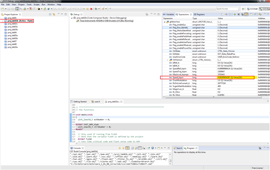

  • You were right about the compiler. Good lord, how long we took to figure that out.
    We added a way to watch the iq and id currents used in the torque calculation and they vary wildly, being the culprit for the crazy torque readings we have. Do you think this may be related to the wrong angle estimate? If so, do you think we should try to increase the flux of the motor?
    Another thing, the unloaded current of the motor is terribly high for the extremely low the friction of our system. Again, do you think this is related to the low flux of the motor (0.07)VpHz?

  • attach your user.h so I can see if I see anything strange.
    you are running proj_lab05a and leaving the current gains as default, correct?
    How do you propose to do that? Are you designing your own motors?  If you did increase the flux with a new design, you would get more torque and less short circuit current (lower current ripple).
    0.07 isn't low unto itself.....twice as much as the standard NEMA17 24V/4A motor we ship.
    All of these things sound like the current controllers are not tuned or the PWM isn't keeping up with the control. Let me look at your user.h

  • This is with proj_lab02b and the user.h I attached?
    What is the ctrl.RoverL value? I've asked you to confirm several things in my above post, please do so.
    This is really strange...the Rs valus should be much more stable than this.
    Please lower this to the minimum value that still allows the motor to start spinning during RampUp phase of motor ID:
    USER_MOTOR_RES_EST_CURRENT      (3.0)
    I would suspect that (1.0) should still allow the motor to start-up.
    Flux value is good and in a correct range.
    The Ls value is very unstable...especially for somethign in the hundreds of uH it should be much more consistent.

  • The image with table we sent before was not done withyour user.h, but the results are similar to your new user.h
    The result of the identification with the user.h you attached in proj02b is below.
    As you can see the inductance identification is not always consistent and other times(like the image below) just invalid. On the other hand the RPMs now follow the reference RPM closely.
    The RoverlL is 2781.303.
    Below is a print screen of the speed on ramp up. Now the speed is correct. We have tried to lower the USER_MOTOR_RES_EST_CURRENT but then the motor doesnt ramp up during the STATE_RAMP_UP, only during the flux estimation. Should we keep trying to get a smaller current until it doesnt ramp up?
    when you see this >= 2000 with proj_lab02b you need to instead try proj_lab02c
    Please run 2c now.
    Low speed is dominated by Rs, so the 0.12 ohm seems pretty accurate.
    Your Ls is invalid (hence the need to use 02c), but at low speed and low load having essentially 0 Ls set still allows FAST to preform ok since Rs dominates the motor model.

    As you noticed before our motor generates a trapezoidal wave-form as generator. Will we get better results with:
    #define USER_MAX_VS_MAG_PU        (4.0/3.0)  ? Whats the main difference?
  • That's MUCH better....I still think you should run some with 2c though. Having the RoverL go > 2000 in 2b is an issue that 2c should solve.
    How does this run?

    You lose some efficiency if your modulation doesn't match your Bemf. So for your trapezoidal motor you do lose a bit of efficiency....but you usally gain it back by the better efficiency of FOC at variable speeds and dynamic loads.
    If you are designing your motor I'd use sinusoidal windings for efficiency.
    You go get a slightly higher initial torque out of trap windings, but it's not worth it IMO for this application.

    The screenshots were forgotten, We send the printscreens in attachment.
    With the USER_MOTOR_RES_EST_CURRENT lower we get it to spin up but it stops then the state changes from State_RampUP to State_RatedFlux.
    We are in UTC time so it is still just 21.00 here :)
    The lab02c
    The lab2b:

    Please confirm: with proj_lab02b the ctrl.RoverL during Motor ID is > 2000?  If so, that's surprising...I need to think about why that woudl happen and why it still works.  What is ctrl.Rhf and ctrl.Lhf?
    That's the expected behavior, per SPRUHJ1 User's Guide after RampUp it moves to RatedFlux.
    Since the motor spins and reaches the Frequency target for RatedFlux at this lower RES_EST_CURRENT please continue to use the lower value and see if your Rs value gets more stable.
    I had you change USER_R_OVER_L_EST_FREQ_Hz from (300) default for the BOOSTXL to (100)....your motor isn't high frequency enough to use (300)...I think this may have been throwing your Rs readings (the next state after RoverL).  You should have stable Rs ID now.
    Yes, it is. Here the screenshots on lab02b and lab02c:
