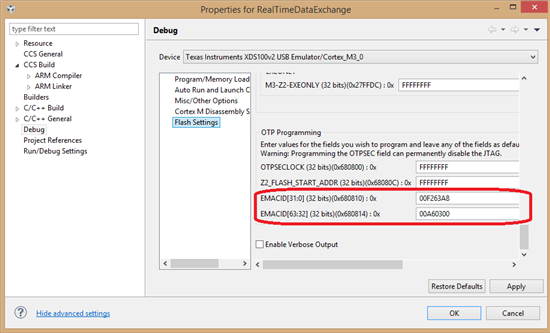

- In Propierties->Debug->Flash settings  you can change the MAC but doesn't take effect when you build and execute.

  • Hi
    Thank you.
    However, I am not able of finding the Flas plugin in Code Composer Studio v5.50.
    I really used the Flash plugin with older versions of CCS but now it seems to be integrated in CCs and also hidden.
    I found this option at the Project propierties, but it doesn´t work:

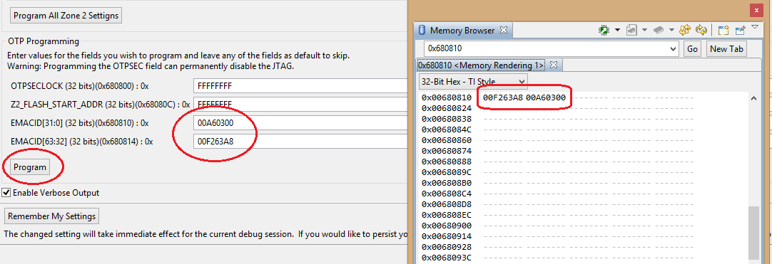

  • Flashplug-in should be available in CCS tools menu in the debug perspective after you connect to the target.
    and yes you would need to use the #PRAGMA directive to put the constants into a user defined section in the source file and link the section to needed user OTP locations in the linker command file. Inspect the Map file carefully before you load because this is user OTP and is one-time-programmable only.
    Best Regards
    santosh
  • It worked! I found the On Chip Flash plugin in the "Debug perspective-Tools-On Chip Flash" and I have already recorded the MAC address in the OTP memory:
    Thank you so much!
