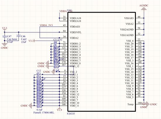

Hello everybody,
I am recently changing from the 176HLQFP176 to the 176BGA package. Since they have the same number of pins, I was expecting to be able to use the same schematic drawing, but the number of VDD and VDDIO are not the same in the packages (one more VDD and one less VDDIO pin in the LHQFP). Is this suppost to be that way or could it be a mistake in the datasheet?
