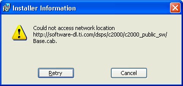

Hello all there,
I just tried to install the new ControlSuite, and downloaded the installer.
After starting it and checking a few items, it tried to download content from TI, but after a few seconds following message appeared:
-> Can anyone give mi an advice, what to do
 Is this a problem of the TI server?
Thanks, Kaspar

    This error message seems to appear occasionally. We're looking into the cause of the problem.
    In the meantime, try hitting Retry a couple times and see if it goes through. If not, hit the Cancel button. Does it let you continue with the installation? If yes, then navigate to the folder C:/TI/controlSUITE/development_kits/~controlCARDs. This folder contains the content that Base.cab installs. Do you see anything in there?
    -Michael

    the error seems not toe be occasionally. It is PERMANENT.
    -> I can´t install the ControlSuite. If I click cancel, the whole installation process stops. There remains not even the directory C:\TI.
    The error message tells me, that I can´t download the file "Base.cab", so I don´t have this file on my computer.

  • Hi Kaspar,
    I had the same problem, fought it for a couple of days. Finally I had to get our IT guys involved. I don't fully understand the issue, but it had something to do with the way the proxy server was configured inside Internet Explorer and our firewall. They temporarily changed to a different proxy server and everything worked as advertised. I hope this is useful.

  • Hi Jedcon,
    I can confirm your suggested solution. When I first tried the ControlSUITE installer I ran into the same error, but when I changed my browser settings to 'Auto-Proxy' it completed successfully.

  • I am still encountering this issues today.
    We have a proxy server and it requires authentication.
    This is probably the root-cause of the problem.
    I was able to reconfigure to bypass the proxy (we use it for performance not security) and then the installer worked.

  • I was having the exact same problems installing controlSuite (Win7 Pro, 64 bit OS).  I was able to successfully install controlSuite only after I turned off Windows firewall, and my antivirus program (Kaspersky).
