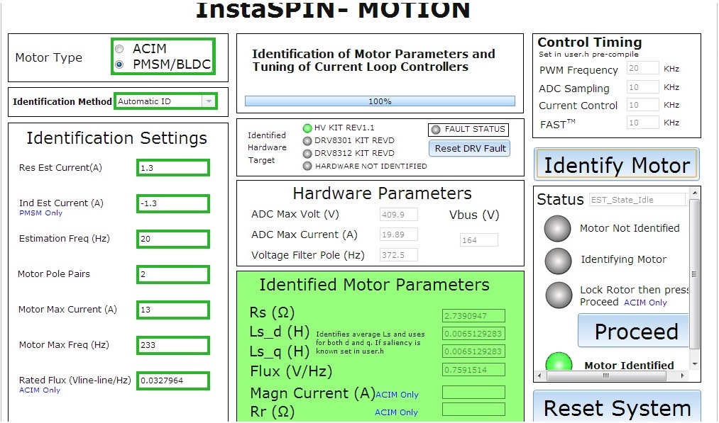

I have a Baldor Motor 4-poles max.speed=7000rpm, max.current=13A, how can'i calculate these two varibles?

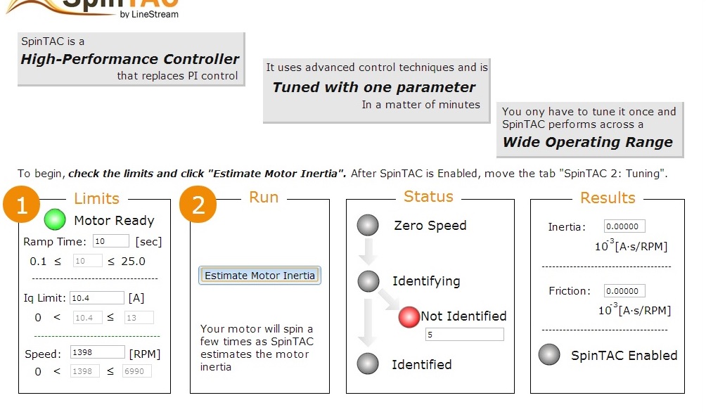

In other way, I tested the motorware to estimate motor inertia with GUI. The motor is identidied and I clique in Estimate Motor Inertia in SpinTAC1:Statup, and then, the statue is not identified=5.

    - Can you ID the inertia with InstaSPIN-FOC & -MOTION GUI?
    - What error do you get when you try to ID with proj_lab5c?
    - For both, before you try to ID inertia is the motor running ok at various speeds?

    I have images shows the error in inertia identification with motorware GUI
  • Hanane,
    Error 5 for Inertia Identification means that the Output Maximum is greater than 1.  This is occurring because the maximum current that you placed in the GUI is larger than the kit maximum current of 10.  If you set this maximum current to < 10 when you start the GUI you will not see this issue.
