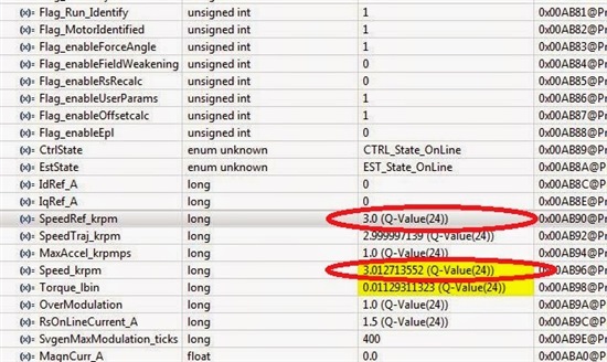

I'm working with DRV8301 kit and TMS320F28069MPZT control board. I can turn the many different motor with using instaspin gui composer v1. But I can not get the same performance from the motor using the lab.
I'm writing in program (lab 2a, 3a, 5c) all the parameters contained in the GUI.
As seen in the picture below very stable motor is turning at 3000 rpm.
However, after 5000 rpm and the motor gets so hot you can not control the speed. Also I write 6000-7000, and 8000 can not change the rpm.
What is the reason?
Best regards.

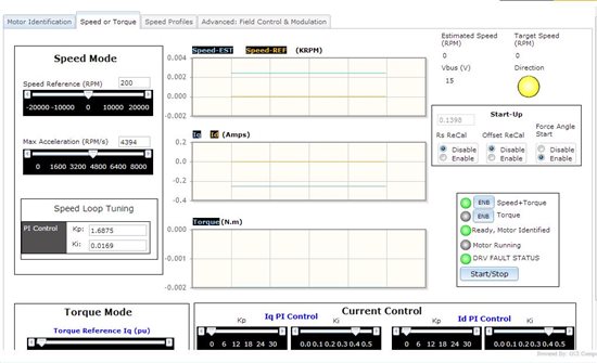

    I add below the data we obtained with GUI. According to these data user.h could you prepare it?
    Thank you in advance for your help.

  • Ahmet BURMA said:
    with the GUI. DRV8301 using the card of 200 to 13,500 rpm motor can rotate in a very stable manner.
    What do you mean?  You use InstaSPIN-FOC or -MOTION GUI to ID the motor and it works well from 200-13,500?
    1. Accordiing to your motor specs, 13,500 RPM would only be 10% of rated speed....so I don't think it's working like you think it is.
    2. In your GUI screen shot you have the max frequency set at 225 Hz.   This is only 13,500  RPM for a 1 pole pair motor.  You say it runs to 135,000 RPM per spec.
    3. I'm frankly shocked that you were able to ID the Ls of this motor to 34uH using DRV8301 EVM and 15V bus.  That usually won't work....but this gives you an Rs/Ls = 4 kHz, which is typical for this type of motor, and an Isc = 165A, which is a bit high for a 9A motor, but typical of how these high speed motors are designed.
    I can't promise that these value are valid....it's very rare that the standard GUI will ID a motor like this correctly...but they seem pretty reasonable and where I would expect.
