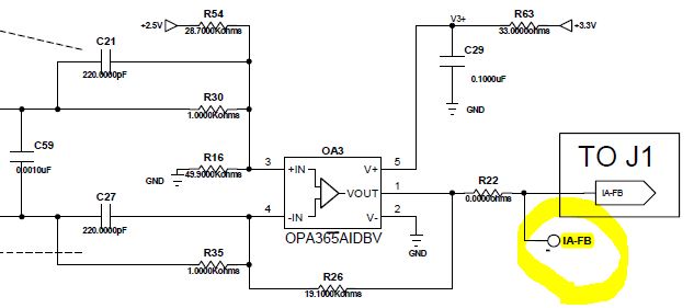

Another silly question.  I would like to measure the currents on the test points using an oscilloscope.  are the test points outputted from an A/D on the board? in other words, are they actually voltages that map current to volts? I do a lot of data acquisiton in my job, where (for example) 0-1 amp = 0-10 volts, where 1V=0.1A.  how do i actually connect the oscilloscope?  and the same for the PWM test points on the board.  Please help, i need to monitor the currents for Lab 5a, and other labs.

    I don't beleive the test points are hooked up to an MCU pin by default.  If you need to monitor the current I highly suggest a current probe.

    You can measure the phase current at the IA-FB test point as below. However, the current will be looked pulse type because current is only captured during Low switch turn-on.
    If you need DAC for current monitoring, you can also use DAC_PWM1(J5-22). Of course, you need to add some codes for DAC output.
    I am not sure if this answer is what you are thinking or not.
    -Steve

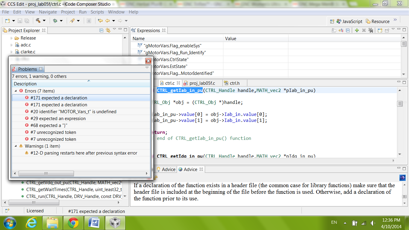

  • After a couple of successful graph of Id, Iq etc., I tried to add a new var. "Ia" to be graphed. But bunch of errors reported after building.
    What I did include:
    1. main.h: add "_iq Ia" in "typedef struct _MOTOR_Vars_t_"; add "_IQ(0.0), \" in "#define MOTOR_Vars_INIT";
    2. main.c: add "gMotorVars.Ia = CTRL_getIa_in_pu(ctrlHandle)" in main ISR;
    3. ctrl.h: add "inline _iq CTRL_getIa_in_pu(CTRL_Handle handle)" to return the Ia value from "CTRL_getIab_in_pu" which is in ctrl.c
    Is there anything I missed? Attaching the error report here...
  • 1. you don't HAVE to put Ia into the gMotorVars structure, but it's ok that you did
    2. if you are going to do this you need to set-up a CTRL_get function which you started to do in 3.
    but for a new function you need to set-up the address and create get and set functions.
    Is this just a value that you can pul from one of the existing functions? Is it one of these?
    void CTRL_getIab_in_pu(CTRL_Handle handle,MATH_vec2 *pIab_in_pu)
      CTRL_Obj *obj = (CTRL_Obj *)handle;
      pIab_in_pu->value[0] = obj->Iab_in.value[0];
      pIab_in_pu->value[1] = obj->Iab_in.value[1];
      return;
  • 1. N/A
    2. The func you provided is already in ctrl.c and my func "CTRL_getIa_in_pu" in my 3 is based on that.
    Anyways, attaching my main.c, main.h, ctrl.c and ctrl.h here...

  • oh, I see what you did. You are pulling the value I suspected you needed. This should work.
    I got this to build by updating main.h
    you need to add another variable to the right place in the structure for Ia.  I placed it 3rd from the bottom.
           _IQ(0.0), \
                             {0,0,0}, \
                             {0,0,0}}
      _iq Ia;
      MATH_vec3 I_bias;
      MATH_vec3 V_bias;
    }MOTOR_Vars_t;
  • But I already have them, havn't I?
    main.h: line 123 and line 183.
  • it looks like it...
    I just did this in MW _12 with InstaSPIN_FOC and myproj_lab10a  and was able to compile

  • So weird... seems the only solution is to go back to the original files and re-do the changes...
    Could you help post me the ORIGINAL main.h and proj_lab05.c ? I'm using MW11.

  • still not working and I highly suspect that ctrl.c and ctrl.h somehow were mistakenly changed...
    Could you post these original two files as well? MW_11

    just a note, when I added this to _12 I was just using instaspin_foc ctrl/main
  • Chris,
    Could you send me ctrl.c, ctrl.h and main.h for _MOTION (MW_11)? Because I was using proj_lab5f.
  • I thought that's what I attached. Again, from MW _11 _motion
    /* --COPYRIGHT--,BSD

  • I think the main.h you gave me was not from _MOTION, since it doesn't have "ST_Vars_t SpinTAC" etc.
  • Just wanna update you that I have found the problem:
    I left blank lines before and after  " _IQ(0.0), \" in main.h initialization part like below:
    _IQ(0.0), \
    _IQ(0.0), \       // add for new var Ia
            {0,0,0}, \
            {0,0,0}}
    Obviously, BLANK LINE means sth to the ccs...
