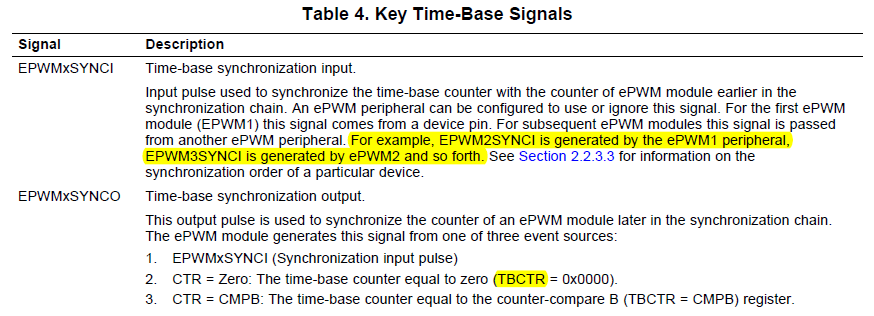

I'm trying to synchronize, at diferent frequencies, ePWM3 and ePWM4 modules on F28027 Piccolo without success.
I've been searching on the internet as well as on TI Forum for solutions, namely I was following an example from this post http://e2e.ti.com/support/microcontrollers/c2000/f/171/p/273846/985435.aspx
but I'm still not able to synchronize the PWM outputs.
I am running out of ideas to solve this issue.. I noticed that synchronization examples are always between ePWM1 and others, can I synchronize ePWM3 with ePWM4? (Being the ePWM3 the master, ePWM4 the slave and Switching freq3 > Switching freq4).

PWM_setSyncMode(myPwm3,PWM_SyncMode_CounterEqualZero); // Sets PWM3x as the Master
PWM_setSyncMode(myPwm4,PWM_SyncMode_EPWMxSYNC); // Sets PWM4x as the Slave

Any idea of the problem?
Thanks in advance.
