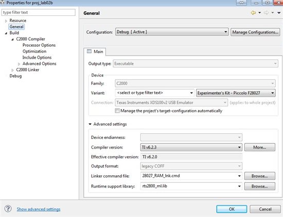

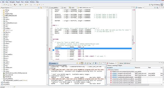

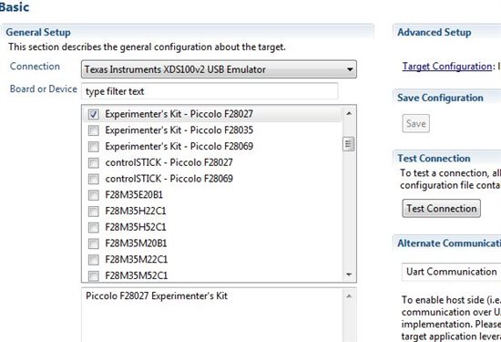

It seems that all my labs in Motorware don't include debug build configurations so I'm having to create them myself.  Also, the kit is not listed in the target configurations so I'm using Experimenters Kit - Piccolo F28027.  I'm not sure if this is the problem or not.

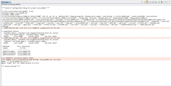

    2. The MotorWare projects for BOOSTXL-DRV8031 + f2802x are set to a Flash build configuration and all work just fine for running and debugging. There is no need to change any settings.  Perhaps you changed to debug which move everythign into RAM. These devices have a minute amount of RAM, so it's not possible to debug an entire application in RAM>

    It appears this is yet another documentation problem.  First, the attachments below are what I mean by "using Experimenter's Kit.

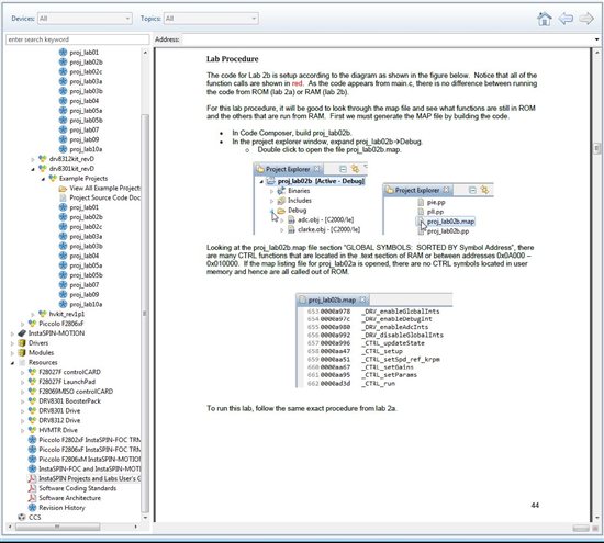

    Second, here is a screenshot of the instructions from TI.  Note it shows and states to use debug.

    On your first topic, you don't have to set-up a Target Configuration. They are provided for you in MotorWare.  However, what you did should work fine.

    For your second topic, the title of the lab is
    Using InstaSPIN out of User RAM and/or FLASH
    I agree that the write-up is the same as when we first released the solution for F2806x (which has plenty of RAM) and ideally should be updated to show the differences when using F2802x (which has almost no RAM).
    I will file this  as a bug for an update.

    Let me focus in a little closer for the debug instructions.  If I don't compile in debug configuration, I'm not going to get a debug directory.  This is why I thought I needed to create a debug configuration.

  • The folder is just named "Debug" because that's the default name used. You could name it "ANYTHING" and it would be the same. It's the folder that holds the output of your compile.
    For F2802x the compile output is called "Flash"
    And in fact, with the F2806x the default is now "Release" and the other build configuration you can select (right click on project name) is "Flash".  "Debug" doesn't even exist anymore, so it needs to be fixed in our docs.
