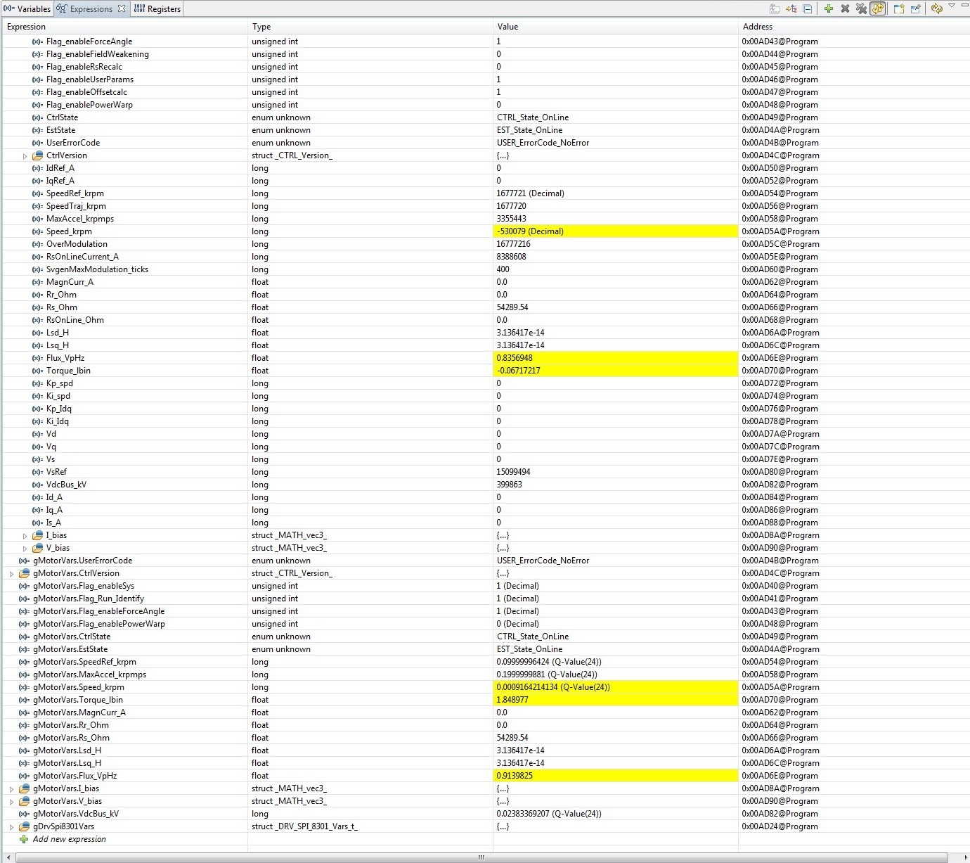

  • Thanks Chris,
    I followed the sticky note on user.h (see my user.h attached) and now I am getting values that are way off and no spinning. I have also attached the specs of the motor that I am trying to control. the following files are attached:
    excel sheet, user.h, screenshot of code composer and motor specs. Any thoughts?
    Sina
    6013.motorware_selecting_user_variables_v2p0.xlsx
    0310.user.h
  • I'm on mobile so can't view the files, but your Rs has a gross error of 56 kohm.
    Are are your phase wires hooked up? Seems like an open.
  • I realized the error in Rs. That is a side effect of changing the values based on the excel sheet. In fact if I run from the InstaSpin Gui with default values it runs the same way as before. Can you please take a look at my user.h whenever you can and let me know what is wrong?
    btw, the screenshot is from running lab02c. Is there a way to type in the values that are know (R, L , inertia) and skip this step? I am interested in doing accurate position control on this motor (with encoder input) but I am stuck on lab02.
    Sina

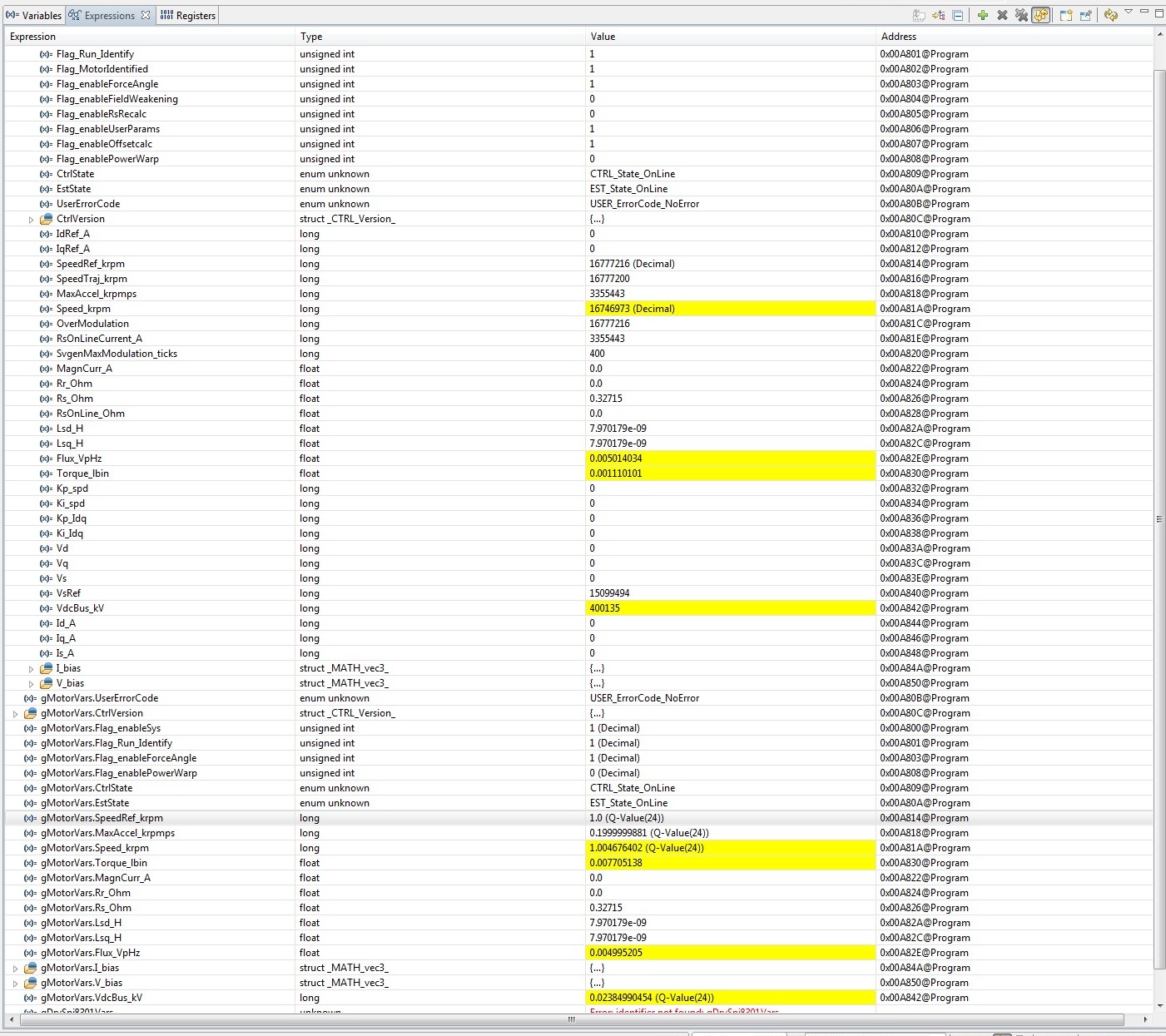

  • Thanks. After updating the user.h parameters I now get a better response with lab2a and lab3. Although lab3 only works for positive ref_speeds and for negative commands it just stops.
    Can you please confirm the encoder pin configuration on J4:
    from 1
    CH A, CH B , IND , 5V, GND ?
    in lab12 the motor does an initial kick but then stops. Is there a switch that needs to be flipped for encoder input? I read this line in the HW Guide under board features("Quad encoder interface and hall sensor interface available for speed and position measurement (only if MCU supports and SW is enabled)")
    Sina

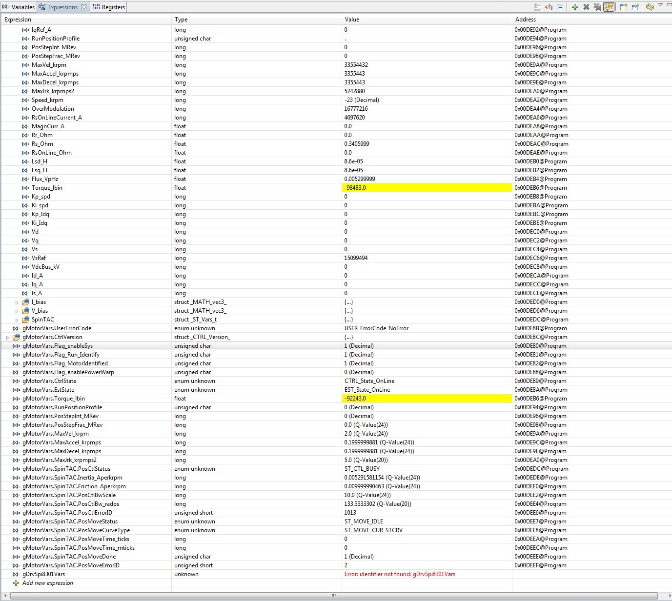

  • Thanks Adam,
    That was indeed the problem. I set the USER_MOTOR_MAX_SPEED to 5 and got it to work. I am pleasantly surprised by the accuracy of position control (steady state error of 0 counts. very impressive).
    The only improvement I would like to make is to make the control faster. The motor is able to spin at 24 krpm and can reach full speed in 2ms. So very high accelerations are possible. What values do I need to change to get to that performance? The lab gives some control over maxaccel and jerk but it seems like there is a cap on these values and currently the motor is running way slower than its full speed. I have set these values to the max value described in the lab (accel of 75 and jerk of 400 max vel of 4.0).
    Where does 0.008 come from and can it be decreased to get higher velocities?
    #ifndef QEP
    #define USER_IQ_FULL_SCALE_FREQ_Hz        (2800.0)   // 800 Example with buffer for 8-pole 6 KRPM motor to be run to 10 KRPM with field weakening; Hz =(RPM * Poles) / 120
    #else
    #define USER_IQ_FULL_SCALE_FREQ_Hz        (USER_MOTOR_NUM_POLE_PAIRS/0.008)   // (4/0.008) = 500 Example with buffer for 8-pole 6 KRPM motor to be run to 6 KRPM; Hz = (RPM * Poles) / 120
    #endif
    Sina
  • Sina,
    I'm glad you are happy with the performance.
    The 0.008 is a default value for us.  This can be reduced to 0.002, minimum.  7 / 0.002 = 3500Hz (30krpm) would be the maximum speed in that case.
    In order to modify the acceleration and jerk to allow for higher values, you will need to stop scaling back to rpm.  The maximum values for the profile are based on limits when scaling to krpm.
    There are two places you will need to modify:
    1. spintac_position.h (in ST_setupPosMove)
    STPOSMOVE_setProfileMaximums(obj->posMoveHandle, _IQ24(1.0), _IQ24(120), _IQ24(120), _IQ20(2000.0));
    These are the maximum possible values for the profile.
    2. proj_lab13b.c (in ST_runPosMove)
    STPOSMOVE_setAccelerationLimit(stObj->posMoveHandle,gMotorVars.MaxAccel_krpmps);
    STPOSMOVE_setDecelerationLimit(stObj->posMoveHandle, gMotorVars.MaxDecel_krpmps);
    STPOSMOVE_setJerkLimit(stObj->posMoveHandle, _IQ20mpy(gMotorVars.MaxJrk_krpmps2);
