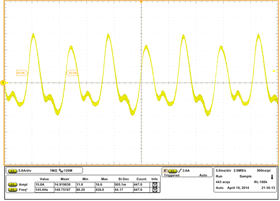

Hi
I am Julio Hernandez from a Dutch company of embedded systems; I am in charge of the motor control for one project; we decided to use the TMS320F28062F, which includes INSTASPIN-FOC. We bought a DRV3801 evaluation module for verify the performance with our motor (the parameters from the motor are attached). I measured the parameters using the InstaSpin reference manual and I compared it with the estimation of the Lab2a of Instaspin and just the Inductance was not the same (my measure with a RCL meter at 100 Hz= 330uH phase to phase; InstaSpin estimator= 320uH phase to neutral).

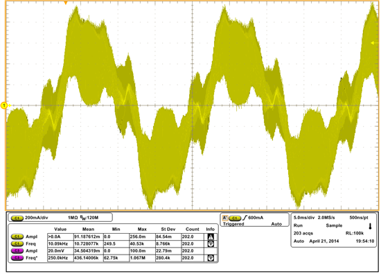

We want to use a PWM signal of 20kHz and a control loop of 10kHz, I configured the user.h file (the parameters are attached) and after some tests the rotor started to spin. The phase current U is showed below; the back EMF of the motor is sinusoidal, so I was expecting a phase current with a sinusoidal shape, but it did not.
I was trying to tune the PI controllers of the Lab5a and Lab5b in order to obtain the sinusoidal shape, but I did not have success. I think, the shape is caused because the magnetic saturation of the machine; I verified the PI controller for the d current (Id) and I found that the parameters are the same as the PI controller for q current, is it correct?.
What do you recommend to do for the next step?

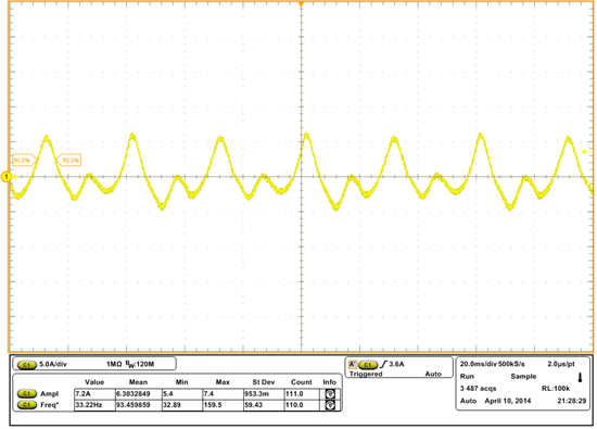

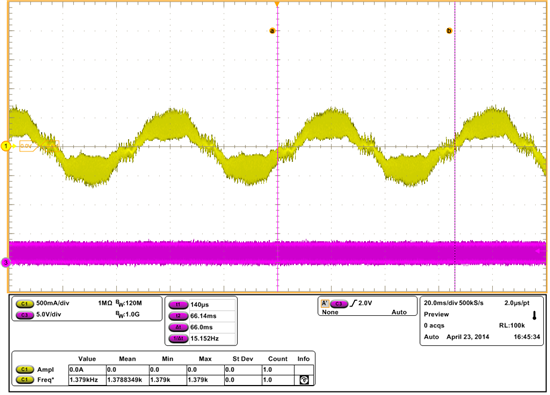

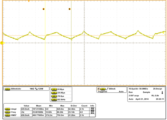

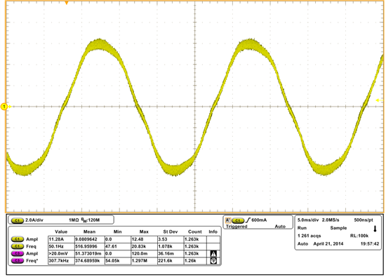

Figure 1. Phase current U, the speed control is set at 100 RPM, no load applied
Figure 2. Phase current U, the speed control is set at 200 RPM, no load applied
Figure 3. Phase current U, the speed control is set at 400 RPM, no load applied
Figure 4. Phase current U, the speed control is set at 400 RPM, load applied

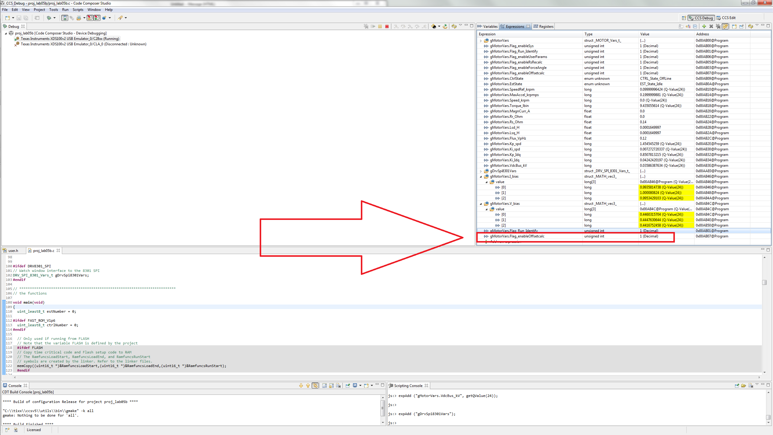

  • Could you make sure you have the offset calibration enabled? You can check with this value, it has to be set to 1.
    controller_obj->flag_enableOffset
    Also, check the offset values that it calibrated by checking these IQ24 variables:
    -Jorge
  • Hi Jorge

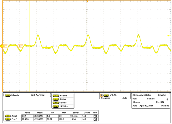

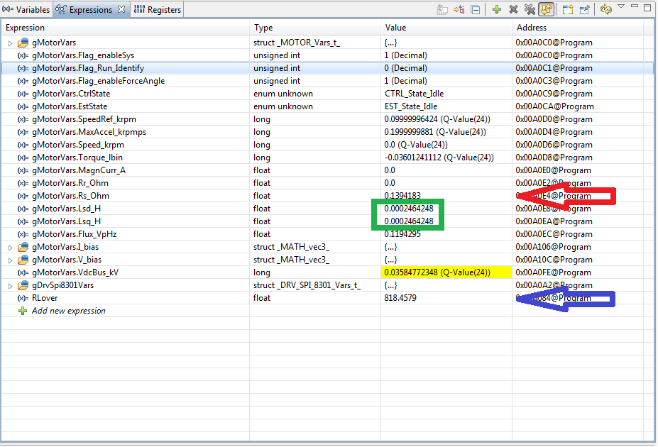

    Thanks for the reply. Yes, the Flag_Run_Identify is set to 1, the figure bellow is a printscreen from the test. I made several test with Flag_Run_Identify=true and Flag_Run_Identify= false, but the phase current still does not look like a sinusoidal shape. Only when the load is applied, the current changed its shape. What do you think? Could you see my user.h file, just for verify if something is wrong?
    Figure 1. Flag_Run_Identify= true, print screen of CCS

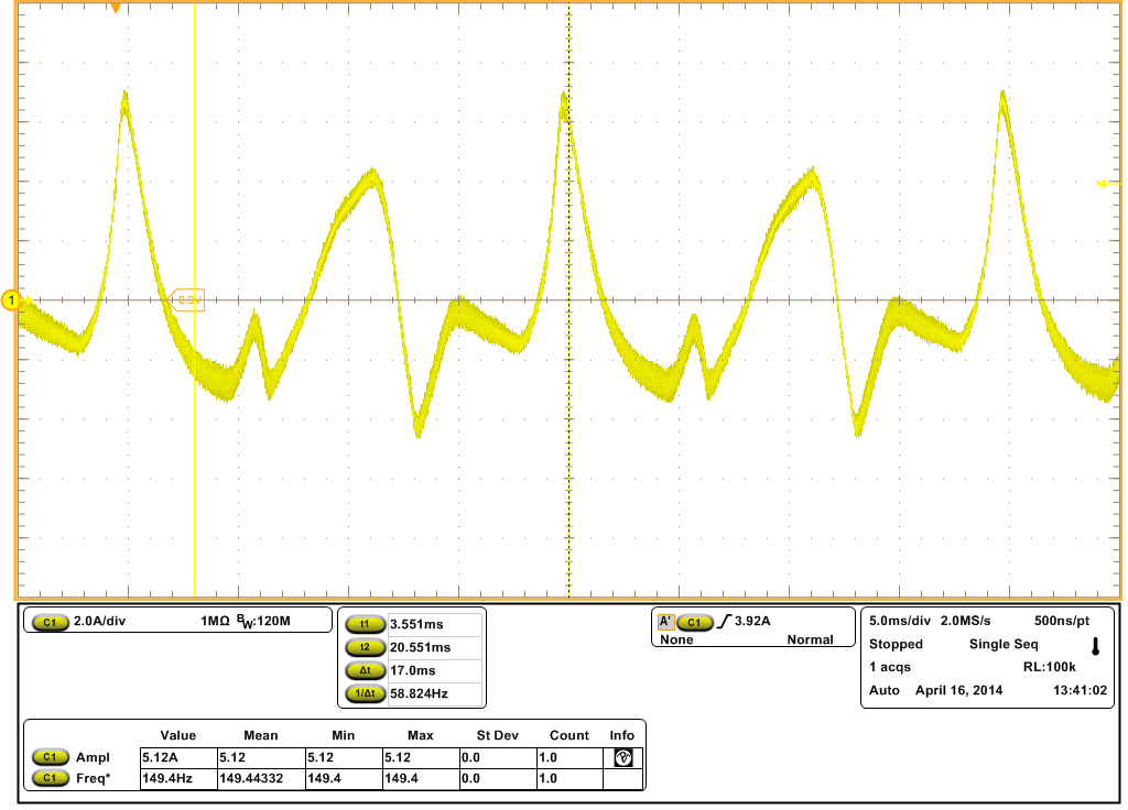

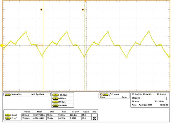

    Figure 2. Phase current U, speed controller set at 100 RPM, no load applied
    Figure 3. Phase current U, speed controller set at 100 RPM, load applied
  • you have a massive short circuit current of over 1500A.  I think you need to run your PWM faster and it probably wouldn't hurt to run your current loop faster as well.
  • Hi Chris
    Thanks for the reply, Where can I change the short circuit current? Is it in the user.h file? I increased the PWM frequency to 30kHz and 60kHz but the current signal has the same shape.
  • Short circuit current is inherrent to your motor design.
    Isc = Flux (in wB, or covert from V/Hz divided by 2*pi) divided by Ls
    1. are you sure your parameters are correct?  It is a very large flux and a very small Ls.
    2. If they are close to correct, as stated you certainly need to PWM faster.  Have you looked at the outputs of your competitor's controller to see what PWM rate they use?  Can you post a scope of their current waveform in the same conditions?

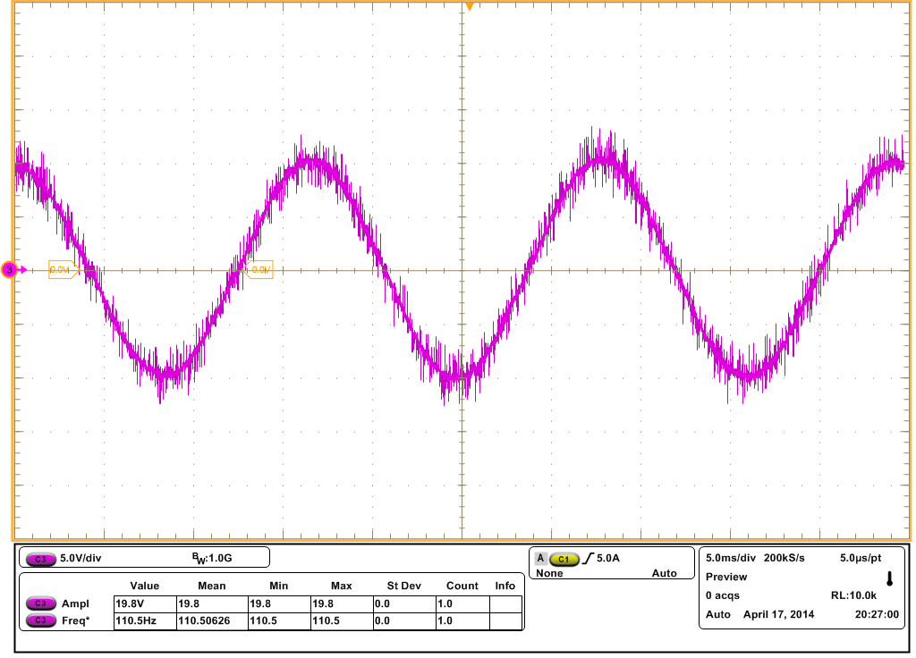

    Figure 1. Phase to Phase back-EMF signal at 100 RPM
    Figure 2. Phase to Phase back-EMF signal at 300 RPM

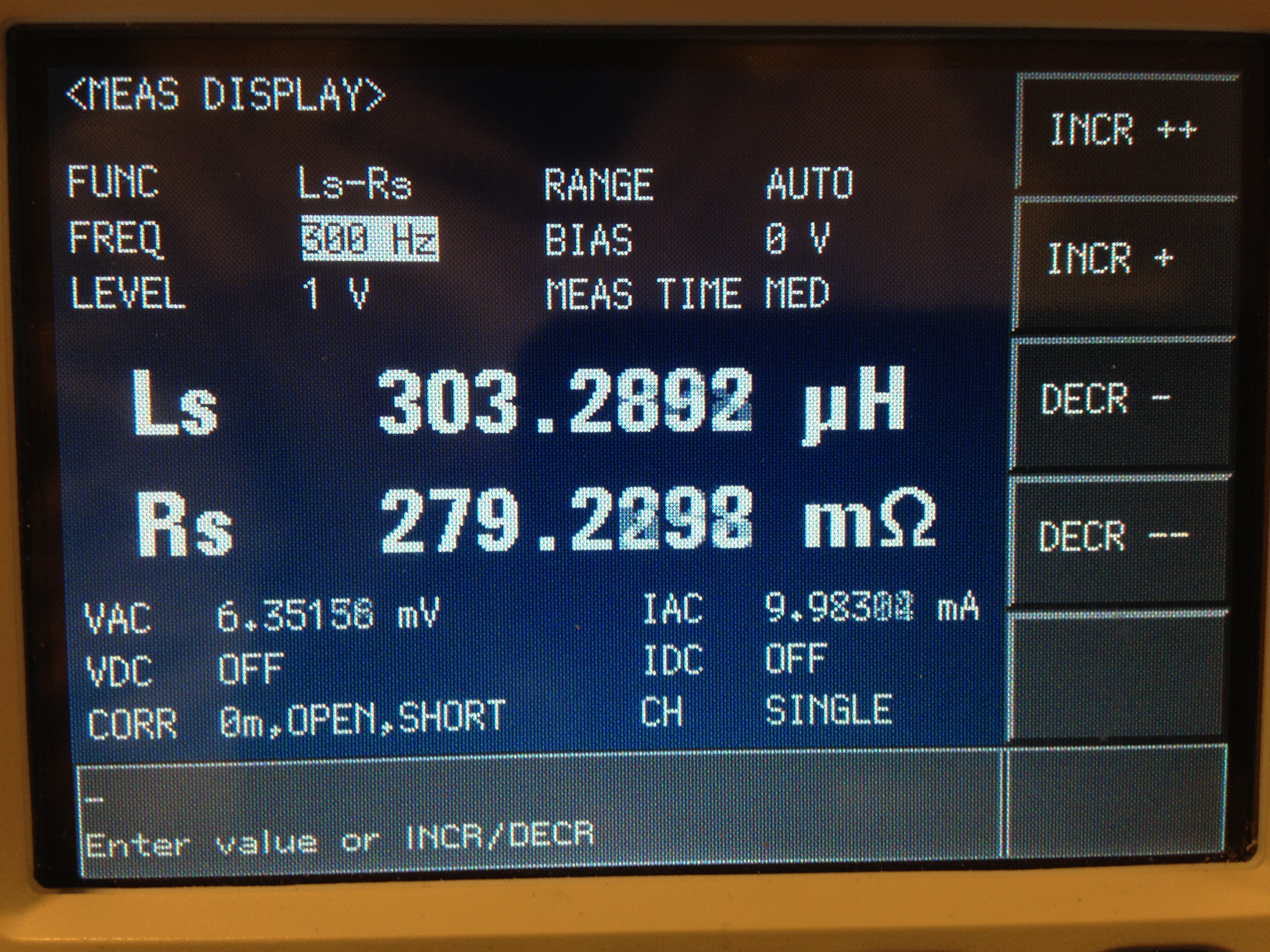

    I obtain the inductance from a LCR meter with a frequency of 200Hz (which is greater that the maximum electrical frequency of the motor, Electrical Frequency= Maximum Speed*Pole Pairs / 60= 900*10/60=  150Hz) the result is Ls= 330uH and Rs= 324mOhms phase to phase. I don’t know if the machine is salient poles or non-salient poles, I am using the average of the measurements with the LCR meter.

    I made a test in the Lab2a with your suggestions in the user.h file, but the phase current shape is still non-sinusoidal. The figure below shows the behavior of the motor.
    Figure 1. Phase current U with speed controller at 300 RPM
    As we were expected the RoverL value is around the 800 Hz, the estimation is Rs= 0.139Ohms, Ls= 0.000246H and PMflux= 0.11942; but, if the RoverL and Rs values are used for solving the Ls value:

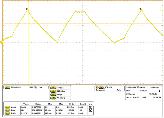

  • you see the same waveforms with the DRV8301 and the same motor?
    can you try a different motor...let's prove both HW is working fine first.

    I made all the tests using the DRV8301 EVM; the hardware prototypes for the project will be ready in two weeks. I made the test with another motor, this one has similar parameters than the last one (PMSM, 10 Pole pairs, Rated torque 7 N.m). Using the LCR meter, at 300 Hz, the Rs= 0.279Ohms and Ls=0.000303H in a phase to phase measuring.
    Figure 1. Photograph of the LCR meter at 300 Hz

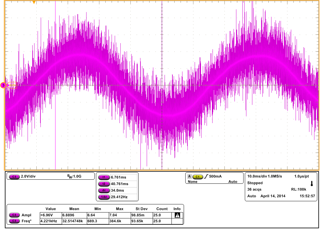

    On the other hand, the PM flux was calculated using the back-EMF signal at 100 and 300 RPM, the result is PMFlux= 0.099 V/Hz.
    a)
    b)
    Figure 2. The back-EMF signal obtained at a) 100 RPM and b) 300 RPM

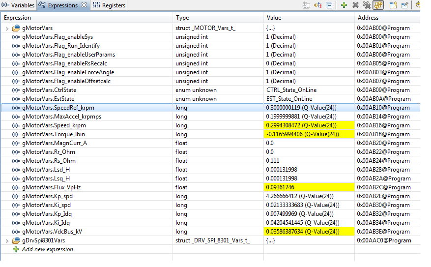

    Using the Lab2a from InstaSpin, the estimation is Rs= 0.1110547, Ls= 0.0002209333 and PMFLUX= 0.09422; as with the other motor, only the Ls is different.
    Figure 3. PrintScreen of Lab2a parameters
    The RoverL=835.4614, and solving for Ls= Rs/RoverL= 0.1110547/835.4614= 0.000132H, almost the same than the LCR meter.
    Meanwhile, I tested the motor using the Lab5b using the Rs and PMFlux delivered by InstaSpin and the Ls calculated above; unfortunately the shape of the phase current is non-sinusoidal.

  • This is strange...I'm surprised the motor runs at all if that's really the phase current.
    1. How are you measuring the phase current? Is this a calibrated current probe?
    2. Please go through motor ID process again, and please capture scope plots of the currents during
    EST_State RoverL
    EST_State Rs
    These should be very clean signals
    Attach the user.h you use just in case I missed something.

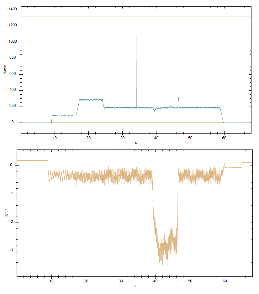

    Yes, the rotors are spinning and both have very high torque, I am surprised too. The speed estimation and the torque estimation are very close to the measuring with a torque sensor coupled in the shaft of my testbench. The figure below shows the Speed and Torque plots from the toque sensor interface.
    Figure 1. Speed and Torque plots from the toque sensor interface

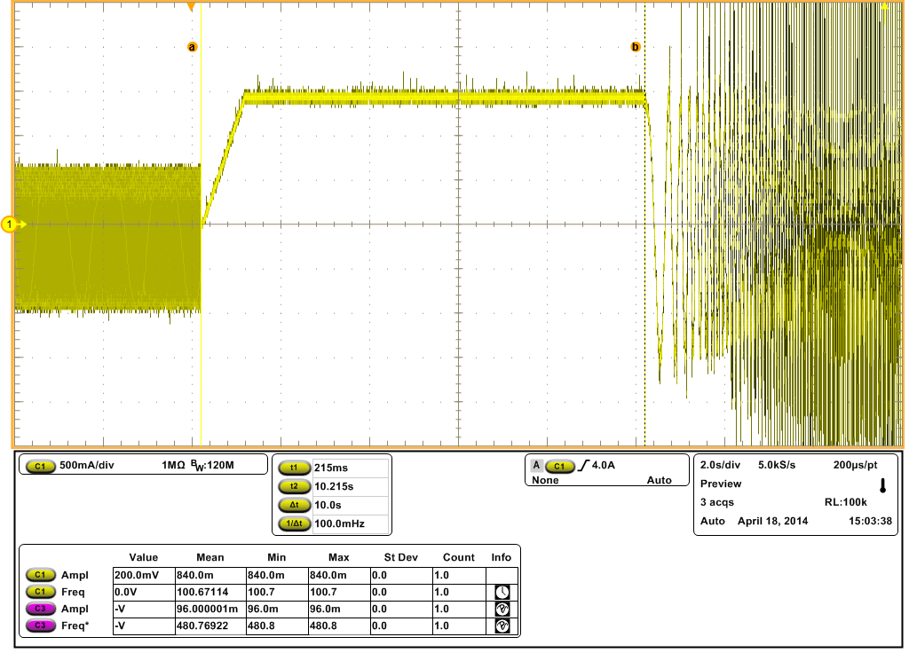

    I verified the parameters suggested in the chapter 6 of TMS320F2806xF InstaSpin-FOC, I made a change in the USER_MOTOR_RES_EST_CURRENT from 2.5 to 1.5 (the user.h file is attached); the plot of the fisrt part of Lab2a is showed below:
    #elif (USER_MOTOR == MY_MOTOR01)
    #define USER_MOTOR_TYPE                 MOTOR_Type_Pm
    #define USER_MOTOR_NUM_POLE_PAIRS       (10)
    #define USER_MOTOR_Rr                   (NULL)
    #define USER_MOTOR_Rs                   (0.1394183)
    #define USER_MOTOR_Ls_d                 (0.000170)
    #define USER_MOTOR_Ls_q                 (0.000170)
    #define USER_MOTOR_RATED_FLUX           (0.1194295)
    #define USER_MOTOR_MAGNETIZING_CURRENT  (NULL)
    #define USER_MOTOR_RES_EST_CURRENT      (1.5)
    #define USER_MOTOR_IND_EST_CURRENT      (-1.5)
    #define USER_MOTOR_MAX_CURRENT          (11.0)
    #define USER_MOTOR_FLUX_EST_FREQ_Hz     (20.0)

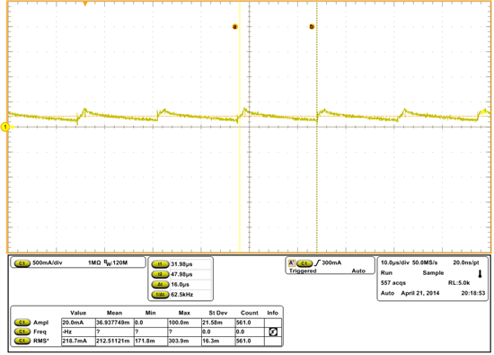

    Figure 4. InataSpin Lab2a estimation process

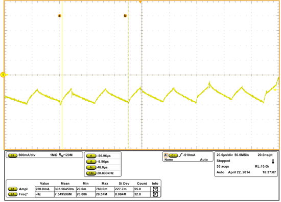

    EST_State RoverL
    In the EST_State RoverL, the high frecuency injected has the configured frequency but the amplitude of the signal is not symmetric; the figure 5 shows the difference between the positive side and the negative side.
    Figure 5. Difference of the magnitude between the positive and the negative side signal from the RoverL process
    EST_State Rs
    In the EST_State Rs, the magnitude of the DC current applied corresponds with the USER_MOTOR_RES_EST_CURRENT=1.5 and the time (10s) configured in the user.h and user.c files respectively.
    Figure 6. EST_Sate Rs process
    1.- Do you think that the difference between the amplitude (positive and negative) in the EST_State RoverL process is a symptom of something?
    2.- In the the chapter 6 of TMS320F2806xF InstaSpin-FOC the plot in the figure 6-15 shows a period of 7s for the EST_State Rs process, Do I have to change this value in the user.c file?
    Thanks in advance

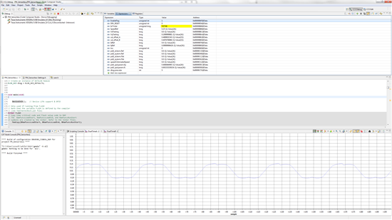

    Today I tried something different, I used the PM_Sensorless project from CONTROLSUITE and I couldn’t pass from the “Level 1A (SVGEN_MACRO Test)”, I was expecting to see the SVM signals in the Graph tool of CCS and the DACPWM ports in the DRV8301 (J6) but it did not happen; the figure 1 shows the result (I forgot to take a plot from the oscilloscope, but it was the same that the Graph tool of CCS)
    C:\ti\controlSUITE\development_kits\DRV830x-HC-C2-KIT_v105\PM_Sensorless
    Figure 1. Level 1A (SVGEN_MACRO Test) of the PM_Sensorless project running on DRV3801 EVM

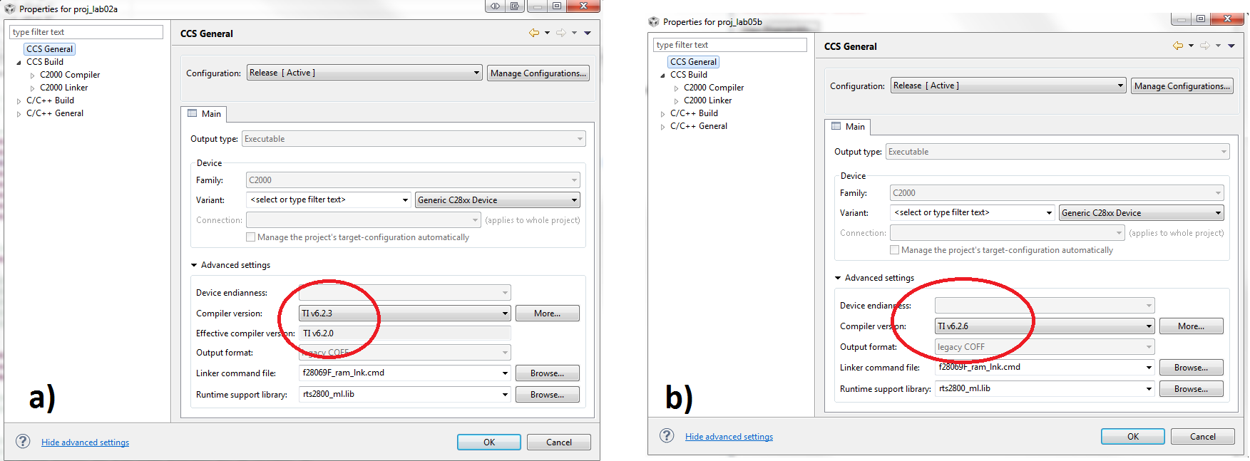

  • The RoverL current not being symmetrical is a concern.
    Could you confirm your compiler version? We had an issue with 6.2.0, 6.2.1 and 6.2.2, so you have to avoid those versions. You can see the compiler version by right-click the project, build settings
    Keep in mind that some times there are two columns, one showing the intended compiler version, and one showing the "effective" compiler version. The effective is the one that was actually used. If the effective version is not at least 6.2.3, download newer versions of the compiler under Help - Check for Updates:
    Let's first see if it is a compiler issue.
    -Jorge
  • Hi Chris and Jorge
     I made the changes suggested by Jorge and the phase current starts to look sinusoidal. I had a Compiler 6.2.3 (I thought  that it was enough) and I update it to 6.2.6, the figure below shows the before and after the updates:
    Figure1. PrintScreen a) Before the updates and b) After the updates
     The phase current at 300 RPM with and without load looks like this:
    a)
    b)
    Figure 2.- Phase current U with a speed controller at 300RPM a) whitout load and b) with load applied
    I think that this problem is solved, thank you so much guys.
    I still having some doubts (Do I have to make another post?):
     1.- I rebuild the PMsensorless project after the updates of the compiler and the SVM signal still without a proper shape with my TMS320F28069MISO control card, How is it possible? Is it still something wrong?
     2.- The Lab2a is giving a Rs= 0.14 Ohms, Ls= 250uH and PMFlux= 0.119V/Hz with the Motor 01; one more time, the Ls is not close to the inductance measured by the LCR meter (165uH). However, the RoverL= 835.35 and with this data the Ls= 167uH. What is the appropriate value for INSTASPIN?
     3.- I made some test of speed and torque in the Lab5b and the estimation is very close to the data obtained with the Torque sensor mounted in the shaft. However, the frequency of the of the PWM signal is not fixed, it looks like two times the desired frecuency. The figure 3 shows the PWM signal at 7kHz and the speed controller at 100 and 500RPM respectively, since the figure 4 shows the PWM signal at 30kHz and the speed controller at 100 and 500RPM respectively. Is It correct?
    a)
    b)
     Figure 3. PWM signal at 7kHz and the speed controller at a) 100RPM and b) 500RPM
    a)
    b)
     Figure 4. PWM signal at 30kHz and the speed controller at a) 100RPM and b) 500RPM
    Thanks one more time
  • your problem was that the EFFECTIVE compiler was still 6.2.0 which has the IQMath bug mentioned in the Sticky post.
    what is your max speed (in Hz) again?  please upload your user.h
    in general it's always better to use the lower value...and I agree that the 250uH looks too large for this motor.

    Hi Chris
    Yes, that was the problem, I am sorry.
    I re-calculate the parameters of the user.h (it is attached) file as you suggest, this time I used the maximum parameters from the motor with a headroom of 30%
    The USER_NUM_PWM_TICKS_PER_ISR_TICK=1 and the USER_NUM_ISR_TICKS_PER_CTRL_TICK=1.The parameters which suffered a change are listed below:
    #define USER_IQ_FULL_SCALE_FREQ_Hz        (266.0)
    #define USER_IQ_FULL_SCALE_VOLTAGE_V      (54.0)
    This time I set the reference speed at 100RPM and 800 RPM, as you can see in the figure 1 and 2 respectively. At 100 RPM the motor control frequency looks like 40 kHz, but in the 800 RPM test I saved to different frequencies(in the same test), the first one at 20 kHz and 40kHz
    Figure1. Speed set point at 100RPM
     a)
    b)
    Figure 2.- Speed set point at 800RPM, a) frequency of 20kHz and b) frequency of 40kHz
    What do you think? Am I measuring wrong?

    I tested the lab2a again and the results are: Rs=0.140 Ohms, Ls= 0.000230uH and PMFLUX= 0.12 V/Hz, the value in the USER_MOTOR_FLUX_EST_FREQ_Hz did not make a big difference in the Ls estimation. I am going to keep the Ls= 0.000165H value.

    I did not change other files, but I measured the output of the EPWM1A in the pin25 of the connector J5 in the DRV8301 EVM. The figure below show the result, I think that I was mixing the MOSFET signals, the PWM signal is always 15 kHz
    a)
    b)
    Figure 1. Phase current U, speed controller set at 100RPM and the EPWM1A signal a) The total view of the phase current b) the zoom to the PWM frequency
    What do you think? Could I start the develop of our own project now? Thanks for all your help
