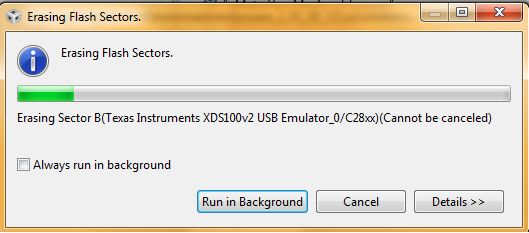

  • alan alban said:
    one thing I noticed is that my code actually programs the chip (the way it would if the RAM lnk file were being used)
    Another thing, when the flash code is loaded to the MCU by CCS debugger, the state in the box to erase the flash will appear:
    This will not appear when you load your code to RAM. Can you confirm that this happens in your case?
    Maria
