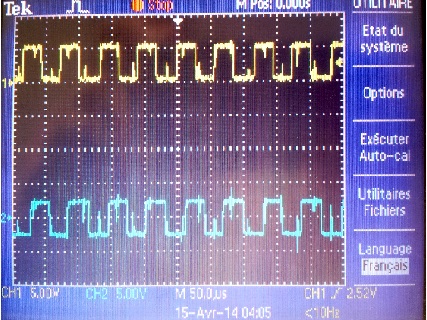

I have some problem with Lab12. The motor connected and encoder too (A,B), but the motor don't spin.
I verified the motor phase lines are correcte, The USER_MOTOR_ENCODER_LINES=2048ppr, also i verified the motor encoder lines connections are correcte
before this lab12 i do lab5c as mentioned.
I have encoder output (A and B outputs) figure when the motor spin. There are some noise. is this noise can have effect?
  • Hanane,
    Noise on the encoder will cause some issues, but this isn't enough noise that I would expect it to cause issues.
    We also need to verify that the encoder is going in the correct direction.  After you load Lab 12, do NOT set "gMotorVars.Flag_enableSys" & "gMotorVars.Flag_Run_Identify".  Add "st_obj.vel.conv.Pos_mrev" (Q24 variable) into the watch window.  This variable will tell us what the encoder is reading.  Manually rotate the motor in the direction that it spun in Lab 05c (usually anti-clockwise).  You should see the value in "st_obj.vel.conv.Pos_mrev" increase.  And after 1 manual rotation the value should be 1.0.
    If that value decreases as you manually rotate the motor, you should switch A & B.

  • Hanane,
    We can check if the encoder noise is causing issues.
    1. Add "st_obj.vel.ctl.RES" into the watch window, this will place the speed controller into reset
    2. Add "st_obj.vel.conv.Por_erev" (this is Q24) into the watch window, this is the electrical angle reading from the encoder.
    3. Set "gMotorVars.Flag_enableSys" & "gMotorVars.Flag_Run_Identify" to 1.
    4. Set "st_obj.vel.ctl.RES" to 1, this will place the velocity controller into reset and our Iq reference will be 0.
    5. Watch the value in "st_obj.vel.conv.Pos_erev" unless you manually move the motor this value should not be changing.  If this value is changing than the noise on the encoder is causing issues.
    I put a filter in the encoder, it works well without connecting with Instaspin. When I connect A and B and GND to Instaspin, there a lot of noise
  • Hanane,
    That is not surprising.  You are most likely going to see noise on the encoder signals when the PWM is running.  Fi the PWM is not running I would not expect you to see noise.  You could also try shielding the encoder cable and grounding the motor case.  Both of these should help with the noise issue.
