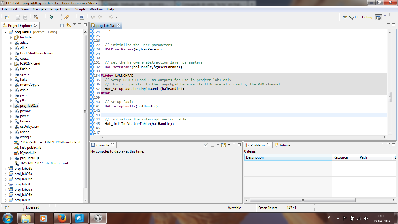

I starded my intership 2 weeks ago and the first work that they assign to me was develop an high voltage motor control with InstaSpin FOC. They already had the C2000 LaunchPadXL with TMS320F28027 for the V/f control,but that isnt enough for what they want, so they replace the TMS320F28027 by the TMS320F28027F at the same LaunchPad to be possible use the InstaSpin FOC control. So, I started search about that and decide to start debugging the projects on the Motorware for the hvkit_rev1p1. Follow all the steps to import the projects, update the compiler and etc,etc.... When I start the build and the debug i havent any problem, but the Led dont blink, so I think that the debug wasnt really successfull. I tried with the same project but now choosing other kit on Motorware, eg. boostxl_drv8301_revB. Import the project, debug and now the led blink. The code it's the same(I guess), the difference its at the line 134 until line 138, of the hvkit_rev1p1, the background instead be white its grey and i dont understand why! maybe the problem its here,i dont know...

    If you use LaunchPad XL F28027F, indeed you need to select the motorware firmware under \boostxldrv8301_revB folder.
    The main file is the same (proj_lab0xx.c) but the hal module (hal.c, hal.h, hal_obj.h) is different and the files are made  specific to the board (GPIO setting, etc). You can find the files here:
    C:\ti\motorware\motorware_1_01_00_12\sw\modules\hal\boards\boostxldrv8301_revB\f28x\f2802x\src
    Also user.h is different.
    C:\ti\motorware\motorware_1_01_00_12\sw\solutions\instaspin_foc\boards\boostxldrv8301_revB\f28x\f2802xF\src
    It is made based on the board specification (voltage scale, etc) so you can not use user.h from HVKIT.
