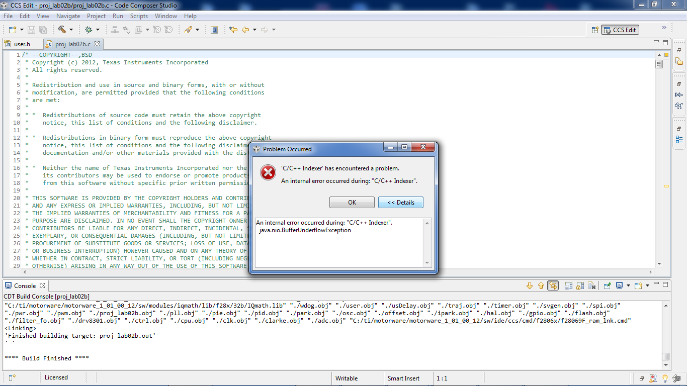

    from lab 2 into the user.h file and went on to 2b. While building I got this error and build stopped. (see screen shot)
    Would it help if I got an umbrella between me an this dark cloud over my head?

  • Darn, here is the attachment.
  • Update:
    After twiddleing my thumbs for a  while I decided to shutdown CCS and start it again. This time no error.
    Went though lab 2b ok, however I couldn't find the "debug" file folder to check for "map".  Will enter values into user.h file and excel file and go to 2c. Just wanted you to know I am able to move one.

  • BTW - I have no idea what that error could be...it has nothing to do with the build (your build completed). Something to do with Java?
