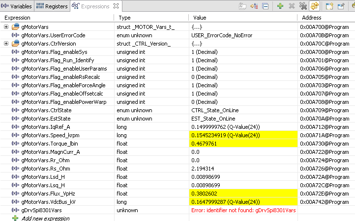

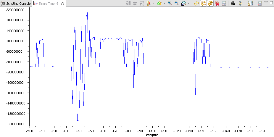

I've been running lab4a successfully using CCS v5.5.  I'm trying to plot various variables, such as Speed_Krpm.  I've checked the forums, and I found out to download HVMotorCtrl+PFC (R1.1) Kit How to Run Guide from Control_Suite. However, I'm using TMDSHVMTRINSPIN,  and will also be using this soultion in my other kits, DRV8312-69M-kit, and DRV8301-69M-kit.  I followed directions as the manual said, but the values are not shown in the format that I can make sense at when i view the plots.  In the graph properties, Acquisition Buffer Size is 200, DSP Data Type is 16 bit signed integer, Q_Value is 15.  Display Data Size is 200.  Now my question is this , Speed_Krpm is defined as Q24.  But when i plot the variable, i don't want see 20000000 on the axis, i would like to see 1.25 kRPM on the plot.  and this applies to any variable I want to plot (that's defined in Q format). Shown in the figures is how I set up the plotting of speed_rpm (I've tried many other values):
I'm trying to graph the spped as shown in the expressions below,
 Now I know that this is incorrect.
so, when the variable is defined as signed int 32, and Q24, I would like to see the nuber on the plot in a
a format i can understand.
Please help me make sense of how to use the graphic capability.
