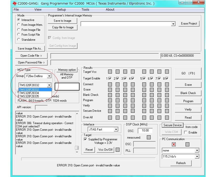

Hi all.
C2000-GANG did not support the Concerto & New Delfino.
Has anyone know the schedule of these devices support?

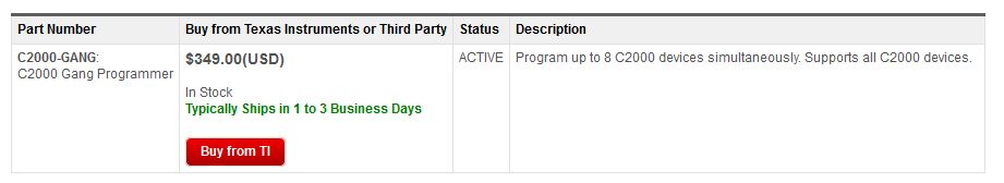

C2000-GANG does support all C2000 devices. Did you check the link: http://www.ti.com/tool/C2000-GANG

Yes FSSer, this is an old GUI. It won't have F28377D in the software but the hardware does support it. You might get an update later this year I guess. As this device will be available for mass only after December, it'll take time.
