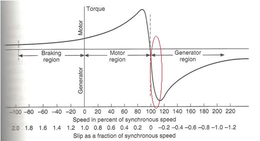

    In the watch window I change IqRef from 0 to -0.2, so I am in the quadrant mode where speed is positive but torque is negative, so there should be generation (the slip is negative, hence a lower frequency observed (measured from one of the motor phases) compared with when IqRef = 0).
    If this is not making sense, definitely let me know please, I have yet to fully explore all the routes.
  • Got it, Adela. I believe you are right. The T vs. w curve is essentially moving towards LEFT to obtain more torq.
    I just reviewed the curve below again and found the correct operation zone (red circle) we're talking about.
