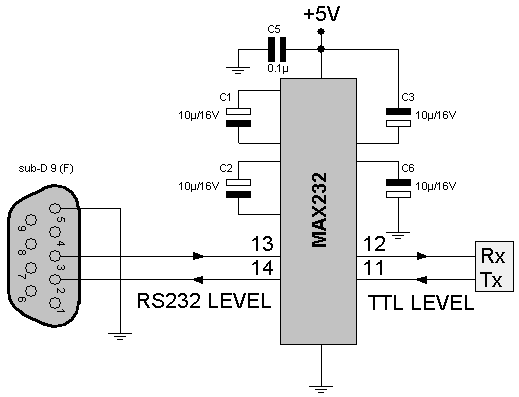

  • what is level shifter curcuit(MAX232)
    It is required to convert TTL logic (F28027) to RS-232 logic (PC) for SCI/UART communication. Else you won't be able to communicate with PC.
    This is how you can implement the level shifter circuitry:
    Gautam

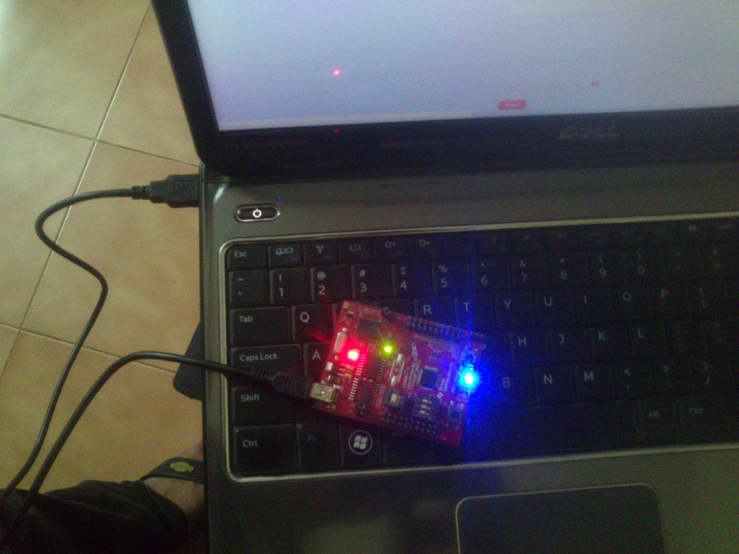

  • Hi gautam
    actually i m using my laptop where I attach my  c 2000 development board with laptop USB
  • The above USB is for JTAG communication, Ashutosh and not for SCI. SCI needs external hardware with RS232 connector to connect to your serial connector on your laptop. This is how you'll be able to see the SCI comunication between controller and hyperterminal.
    I would like you to go through the basics of UART communication to get the clear picture.
    Gautam

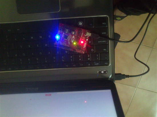

  • Hello Ashutosh and Gautam,
    If we are using Launchpad F28027, actually we don't need level shifter MAX232 because there is FTDI  FT2232H that connected to GPIO28 and GPIO29 (SCI) of F28027.
    So for Ashutosh to test the hyperterminal communication (PC) and Launchpad, please use the example from ControlSuite: C:\ti\controlSUITE\device_support\f2802x\v220\f2802x_examples_drivers\sci_echoback
    You need to choose proper COM port and setting (baud rate, etc) in hyperterminal.
    Here you can see how PC and Launchpad can communicate using hyperterminal. Then later you can modify this example code to send your ADC data to hyperteminal.
