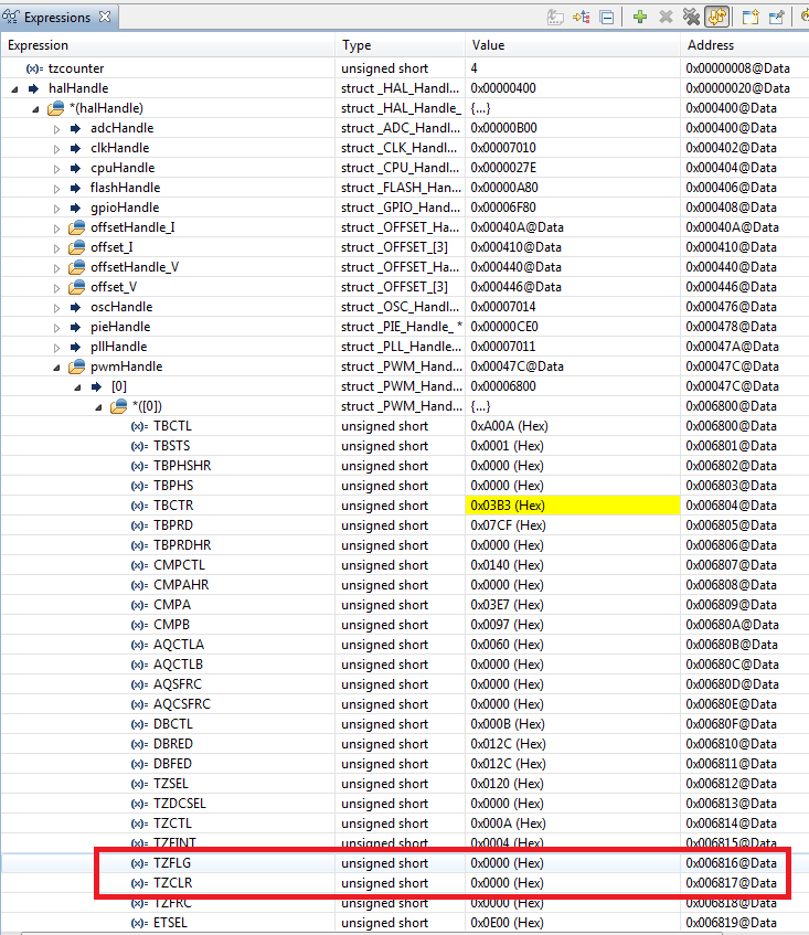

  • at this time ,I test GPIO12 is high voltage.
    After I modified ipmISR:
    interrupt void ipmISR(void) // for testing TZ int
        tzcounter++;
        HAL_tzClearFlag(halHandle, PWM_Number_1, PWM_TripZoneFlag_Global);
        HAL_tzClearFlag(halHandle, PWM_Number_1, PWM_TripZoneFlag_CBC);
        HAL_tzClearFlag(halHandle, PWM_Number_1, PWM_TripZoneFlag_OST);
        HAL_pieAckInt(halHandle, PIE_GroupNumber_2);
        return;
     tzcounter was only incremented until 4 and TZFLG became 0 (means the flag is cleared).
    Maria
