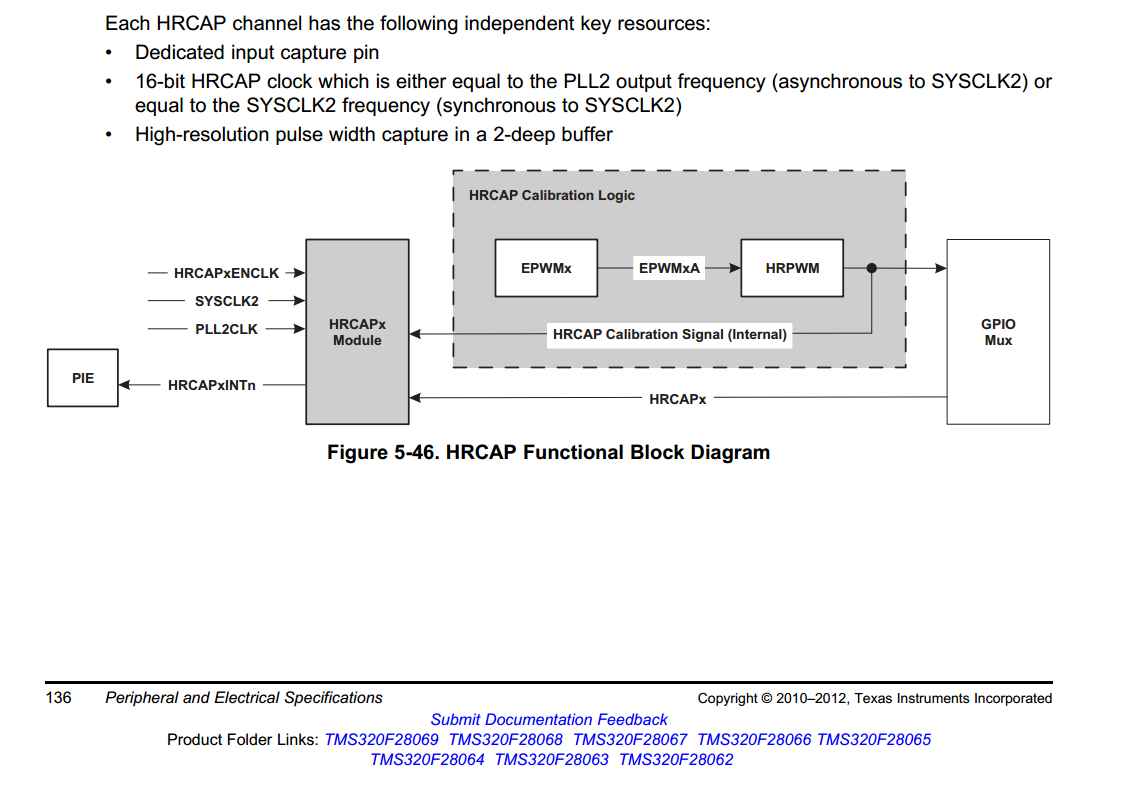

I have noticed a +/-7 cycle jitter while entering the HRCAP2_Isr. The capture result is perfectly accurate, but for my application, the phase relationship between the ISR and the original sampled pulse is critical. Is there a way to reduce this jitter?

  • Looking at the datasheet, it seems that this module can be clocked either synchronously or asynchronously from the SYSCLK.
    Also see this forum post: http://e2e.ti.com/support/microcontrollers/c2000/f/171/p/232141/832351.aspx#832351. It looks like the allowable clock range for this module is 98MHz to 120MHz.  I think because of this you would get jitter when signals from the HRCAP module cross the synchronization boundary back into the SYSCLK domain. Possibly you could clock the HRCAP at 120MHz, and the SYSCLK at 60MHz to avoid any jitter?
  • Currently both HRCAP and SYSCLK are running at 90MHz since I require the HRCAP output to be in cycles I can load into the EPWM timer. This does have been permanence than running the HRCAP lock at 120MHz, but the jitter is still there.
