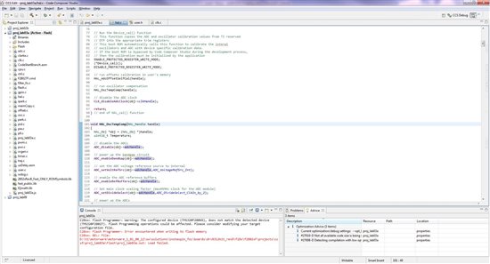

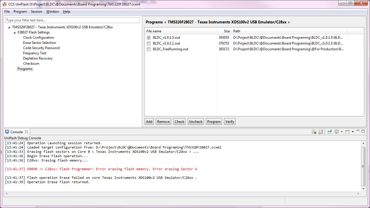

I have encountered an error during writing to flash memory.
In Motorware_12, I edit lap3a for use external crystal so I added some code. It worked fine in motorware_9 but not Moterware_12.
And the worst thing is this code kill my board I designed based on DRV8312&F28027 DK. After I write flash for the first time totally shutdowned, not be able to rewrite even erase.
The code is below.

C28xx: Flash Programmer: Error encountered when writing to flash memory ...
ERROR >> C28xx: Flash Programmer: Error erasing flash memory. Error erasing Sector A
  • Hello Will,
    Seems that you miss something between F28069 and F28027 (the error in your picture said it).
    It seems by default refers to F28069 target configuration file.
    Did you check your target configuration file (it should be for F28027)?
    You can make the new one for F28027 and xDS100v2, or you can get it from here (TMS320F28027_xds100v2.ccxml):
    C:\ti\motorware\motorware_1_01_00_12\sw\ide\ccs\ccs5\targetConfigs
    And link it to your project then make it as Default or Active (by right click on this ccxml file after you link it to your project).
    Maria

  • Yes. Without that code the project in Moterware12 works properly on my board but when I add it error occur. So I think connection with debugger is not the problem.
    I am not sure this is related to your problem or not, but I found that there was bug in Motorware 9:
    //! \brief Enumeration to define the clock oscillator 2 source
    typedef enum
        CLK_Osc2Src_Internal=(0 << 1),  //!< Denotes an internal oscillator 2 source
        CLK_Osc2Src_External=(1 << 1)   //!< Denotes an external oscillator 2 source
    } CLK_Osc2Src_e;
    that has been fixed in Motorware 12:
    typedef enum
        CLK_Osc2Src_Internal=(1 << 1),  //!< Denotes an internal oscillator 2 source
        CLK_Osc2Src_External=(0 << 1)   //!< Denotes an external oscillator 2 source
    } CLK_Osc2Src_e;
    Also please make sure you are using the compiler of CCS5.5 Code Generation Tools 6.2.3 or above (the default from the installer is 6.2.0, and it has bug to use with Motorware).
    Anyway, hope you can find your solution soon.
    Maria
  • Thank you Maria.
    I knew that bug but I didn't know it is fixed after Motorware9.
    My board works fine. But I still wonder why the wrong bit setting causes block the memory access. Dose it use clock source form JTAG when we program or erase flash memory?
    Whatever, Problem solved. Thank you.
