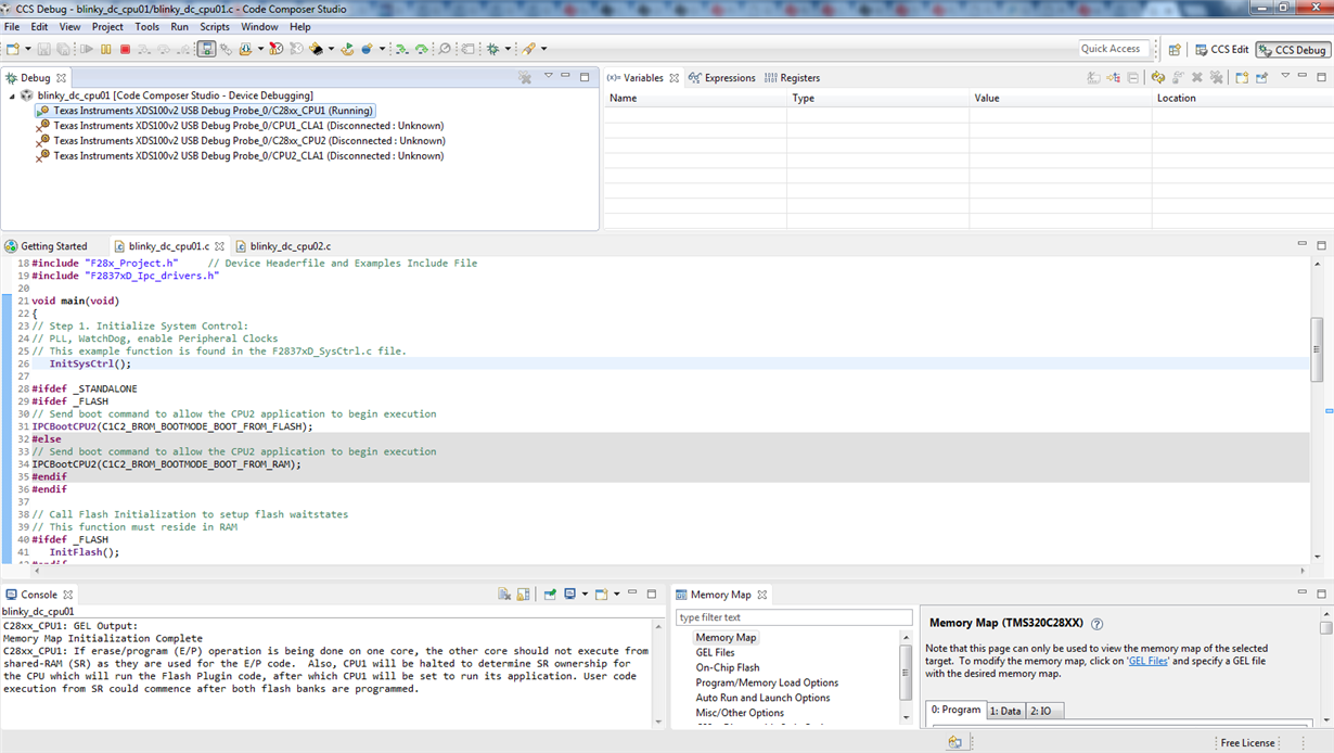

    I'm trying to run this same examples code too, using the model TMX320F28377DZWTT and CCS 6.1.2, but I cant seem to get Flash programming working. I can only get it working on RAM. I'm using this development kit TMDXDOCK28377D to program the chip.
    Correct me if I'm wrong, but all I have to do is change the active configurations to CPU1_FLASH_STANDALONE & CPU2_FLASH and click RUN>DEBUG right? After doing that, nothing happens.
    Could someone tell me what I'm doing wrong. I tried following the steps in the previous comment by Vamsi, and this is what appears in the console:
    C28xx_CPU1: GEL Output:
    Memory Map Initialization Complete
    C28xx_CPU1: If erase/program (E/P) operation is being done on one core, the other core should not execute from shared-RAM (SR) as they are used for the E/P code. Also, CPU1 will be halted to determine SR ownership for the CPU which will run the Flash Plugin code, after which CPU1 will be set to run its application. User code execution from SR could commence after both flash banks are programmed.
    C28xx_CPU2: GEL Output:
    C28xx_CPU2: If erase/program (E/P) operation is being done on one core, the other core should not execute from shared-RAM (SR) as they are used for the E/P code. Also, CPU1 will be halted to determine SR ownership for the CPU which will run the Flash Plugin code, after which CPU1 will be set to run its application. User code execution from SR could commence after both flash banks are programmed.
  • Hi Aaron,
    You have issues with Flash programming or booting from flash? I don't see any error message which indicate the flash programming error hence I think issue could be with booting from flash. If you have got some error message while programming the flash then please share those messages. It'll be good if you also share the screen shot of CCS after you click on RUN -> Debug.
    Vivek Singh
    Note - It's always recommended to start a new E2E post for new issue.
  • Hi Vivek,
    Noted on the E2E post. I thought this was a similar topic, so I'd just continue on from here.
    Anyway, I think I may be having issues with booting from flash. Though I'm unsure. After clicking run -> debug, if I press the 'Resume' button, then only the LED will start blinking. Yet if I turn it off and back on, it doesnt work anymore. So I'm thinking its still not doing flash programming but actually RAM.
    Here is the screen shot.
  • Look like you have booting issue. Please check the setting of BOOT-MODE pins (GPIO72/GPIO84) on the board. These should be set to 1/1 for BOOT to flash option.
    Vivek Singh
  • Hi Vivek,
    That works! Didnt expect it to be such a simple solution. Thank you very much!
    Aaron
