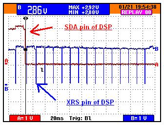

We are using piccolo series DSP TMS320F28069 and using I2C communication with 16k EEPROM (24LC128, Microchip). We face some problem during power off and on condition (one in out of ten trials). In this condition SDA pin become low. Below picture for detail. In this picture red shows SDA pin of DSP and blue shows XRS pin of DSP. Where shows XRS pin shows multiple time reset where SDA pin become low and low.
For this reason I2C communication cannot establish. We try to I2C reset in power on condition but can’t do. What can we do in this condition?
