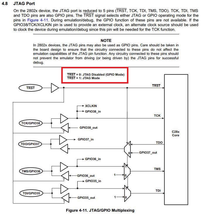

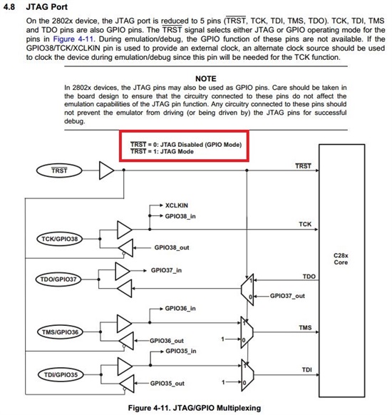

Dear Sir,
I am using Piccolo launch pad for my project.
I have following doubts on GPIO operation.
Can I use the pins GPIO 35, 36 (of General Purpose Port B) as output pin? because this pin is used for JTAG TDI/TDO function.
TRST bit in Device configuration register (DEVICECNF) field is read only. To make that pin as GPIO this pin should be zero.
 That is why I am asking whether I can use this for I/O pins or not.
