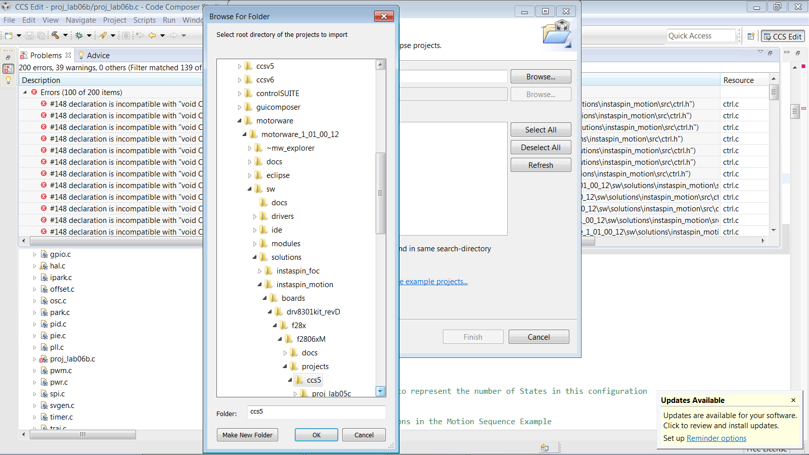

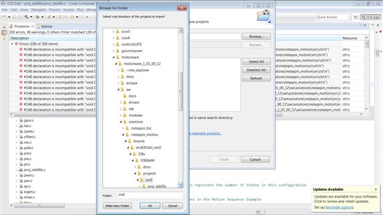

    I removed, MotorWare, control SUITE, and CCS. Re-installed them and I still have these errors. 200 of them.
     The attached screen shows I got them from the right directory.
    What could be wrong?
    David
  • David,
    When you imported the projects into your workspace did you have either of these checkboxes selected?
    Those checkboxes need to remain unchecked in order to use the symbolic linking that is required for MotorWare.
  • No.
    Thank you for your thoughts, good catch, but I havn't done that one yet.
    I did find the problem or solution if you will.my nemesis the user.h file. After cross checking the line in MSW I then check the user file in CCS against my good MSW user.h (doc) file. The numbers were correct but I had gotten the dog gone FOC file again. So I went into the directory after closing CCS and deleted the one in FOC, so for now it won't happen again.
    I have the best luck, the fire alarms are just now going off.
    It compiled fine, I will now try to download it and see what happens, Thanks for you interest  and kindness in helping me.
    David
