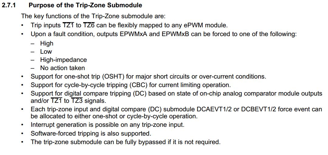

    Yup, you can use Trip Zones to configure such an event.
     Here's more info:
    Also, refer SPRUGE9E for detailed info on Trip Zones for F28035 mcu.

                  The Trip Zones can achieve may achieve that if the trip zones can override.
                   eg:     EPWM1A is forced low by TZ1 and forced high by TZ2
                   TZ1 has forced EPWM1A to low, will EPWM1A go to high when TZ2 is trigered?
  • TZ1 has forced EPWM1A to low, will EPWM1A go to high when TZ2 is trigered?
    Edwin, yup its possible. Please read the above ePWM doc thoroughly. It has all the necessary information.
