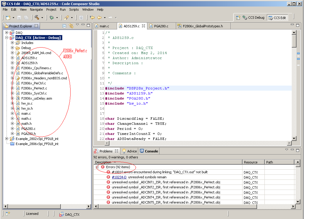

Hi ,
I am using CCS V 5.5 and developing code for the F28069 ,

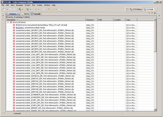

When i build my project I get the error shown below ,
after an extensive search i found out that F2806x_PieVect.c  needs to be added , but after adding the original error disappears and i,m left with about 92 errors , see below
Why does this happen , please let me know in clear and full detail how i should solve this .
Abhay

  • Hello Abhay,
    Definitely you still miss some files, for example: F2806x_DefaultIsr.c
    You can refer to ControSuite example to know what files at least needed for your project, for example: adc_soc that can be found in C:\ti\controlSUITE\device_support\f2806x\v136\F2806x_examples_ccsv5\adc_soc
    Also don't forget to mention the include path in the project properties.
    If you get more error after referring to this example, please tell us again.

  • Hi Maria & Gautam ,
    I was indeed missing a few files but didnt know which and therefore was facing the errors
    After including CodeStartBranch.asm  and DefaultIsr.c the code compiled without any errors
    Thanks for your prompt and excellent advise
