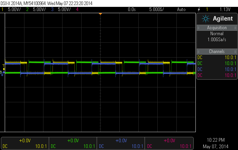

I'm trying to synchronize my ePWM with an incoming square-wave signal on an f28335. However, I want to have a negative phase shift on my output because there is a small delay on my synchronization signal.
So, what I try to do is this (sorry for the bad drawing):
But the output I get is this (the yellow is ePWM1a, the green is ePWM1b and the blue is the synchronization signal):
The relevant code I use for the ePWM:
EPwm1Regs.TBCTL.bit.CTRMODE = TB_COUNT_UPDOWN; // Count up/down
EPwm1Regs.TBCTL.bit.PHSEN = TB_ENABLE; // Enable phase loading
EPwm1Regs.TBCTL.bit.SYNCOSEL = TB_SYNC_IN; // Synchronize with EPWMSYNCI
EPwm1Regs.TBPHS.half.TBPHS = 0x0100; // Phase is 0
EPwm1Regs.TBCTL.bit.PHSDIR = 1; // Count up after sync
EPwm1Regs.TBCTR = 0x0000; // Clear counter

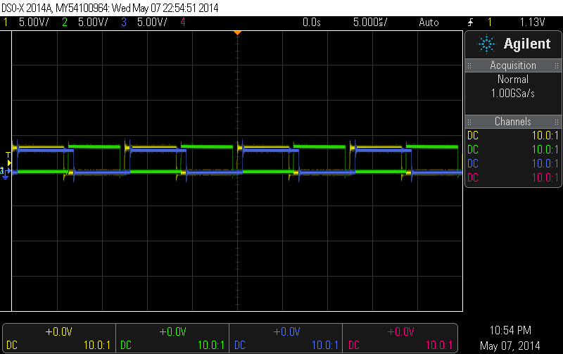

When I change PHSDIR to 0 it works, as shown in the picture below:
So it must have something to do with the phase direction. The TBPRD I use is 0x03A9.
Thanks in advance!
Christian

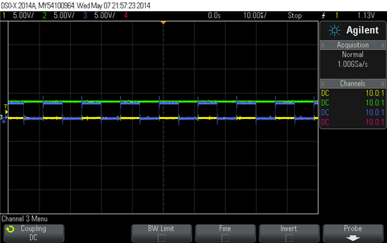

    which in effect phase shifts the PWM output 180 degrees, and then I chose a very large phase shift using TBPHS and a phase direction counting downwards like this:
    EPwm1Regs.TBPHS.half.TBPHS = 0x0300;
    EPwm1Regs.TBCTL.bit.PHSDIR = 0; // Count down after sync
    so now my signals look like this:
    However, this is more abstract and it's harder to intuitively understand what to set TBPHS to in order to have the correct phase shift. So if anyone knows any way of getting my first code to work I would be happy to hear it.
