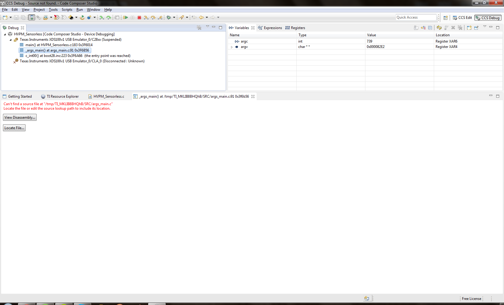

  • Hello again,
    I installed the new CCSv6 and added the cgt comp[iler version 5.2.3 needed to run the HVPM_Sensorless project located in "controlSUITE\development_kits\HVMotorCtrl+PfcKit_v1.7\HVPM_Sensorless". The connection worked well, the rebuild as well, but when i tried to debug the project i got an error
    Can't find a source file at "/db/sds12/scratch/sreeves_rtsbuild_dflcmp0636.dal.design.ti.com_8905_linux/ank_rts/SHARED/args_main.c"
    Locate the file or edit the source lookup path to include its location.
    I have no such file. Can anybody help me? What's more, if anyone has run the project without any errors, could you please tell me what exactly the project does or shows on the screen?
    Thanks in advance.
    Do you have problem on debugging?
    If not, as I know, you can just ignore this error  message and continue with your debugging.
    Maria

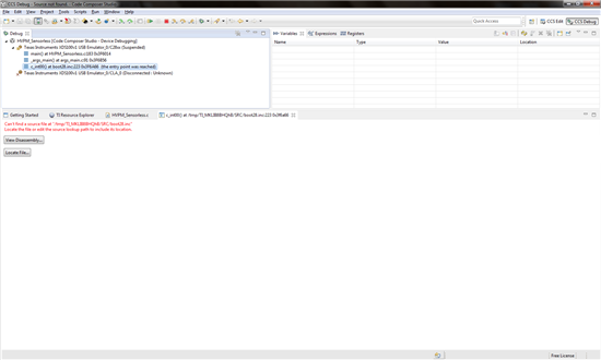

  • Hello and thanks for the fast reply,
    I'll post a picture of the error i get, though that error doesn't stop me from resuming the debug, but simply nothing happens after i press the "resume" button. Now i get two errors as  you can see bellow on picture
    The second error is underneath the first one, and it's shown in the next picture
    I still don't know what will I see in my computer screen though and if my motor starts spinning or something (I guess it should but it doesn't).
    Thanks in advance.
