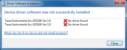

We are using ControlCard  F28M35 in our design. We have connection to the side miniUSB port which is JTAG+UART-over-USB. This Channel B works just fine as Virtual Com Port with CCS installed, but does not if CCS is absent, Windows cannot find a proper driver for XDS100v2 channels
We are very interested to use ONLY channel B of FTDI2232H chip as Virtual Com Port  on PCs without CCS installed, it seems to overkill to install CCS just for the purpose of using this port.
