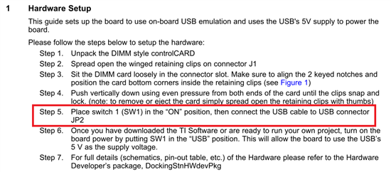

  • Sunil, also check the switches on the controlCard. All should be in the ON position.
    Gautam
  • Hello Sunil,
    I am wondering, did you already set your SW1 (of experimenter kit) to ON position before debugging?
    Maria

  • Dear Gautam,
                              Can you please elaborate which switches you are talking about on the kit?
    regards
    Sunil Behara
  • Sunil, I'm talking about these switches:
    Gautam
  • Yes, they are in ON position. I have uninstalled and reinstalled the ccs 5.5. Now the emulator is being detected and code is getting dumped, but i am getting the following errors :
  • Yes they are in ON position
  • I have reinstalled the ccs 5.5 and it worked for me. The emulator is now getting connected and code is getting dumped. But i am facing some compiling and debugging errors.
