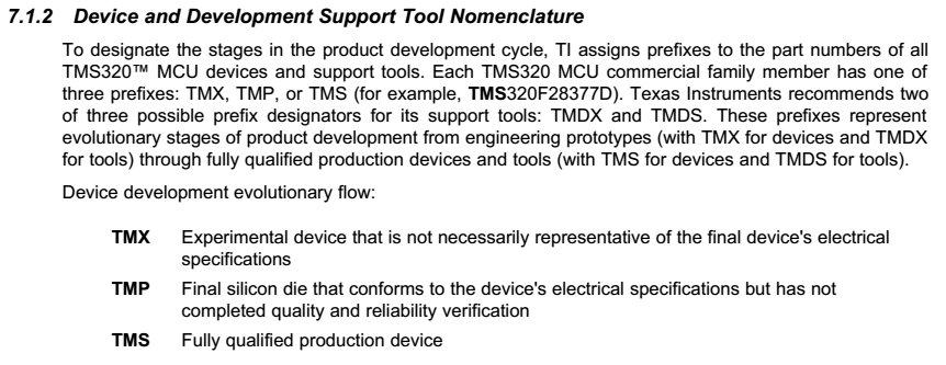

    Thanks for your help. May I ask a simple question? what are TMX and TMS shorted for?
  • TMS and TMX are prefix codes that describe the maturity level of the device.  There should be definitions in the datasheet similar to this snapshot.
  • If I am fully understood, we can only get samples for TMX320F28377D  at this moment.  TMS version is still on PREVIEW status.
    Do you an idea when will TI release TMS320F28377D?
  • The current estimate is early 2015.
