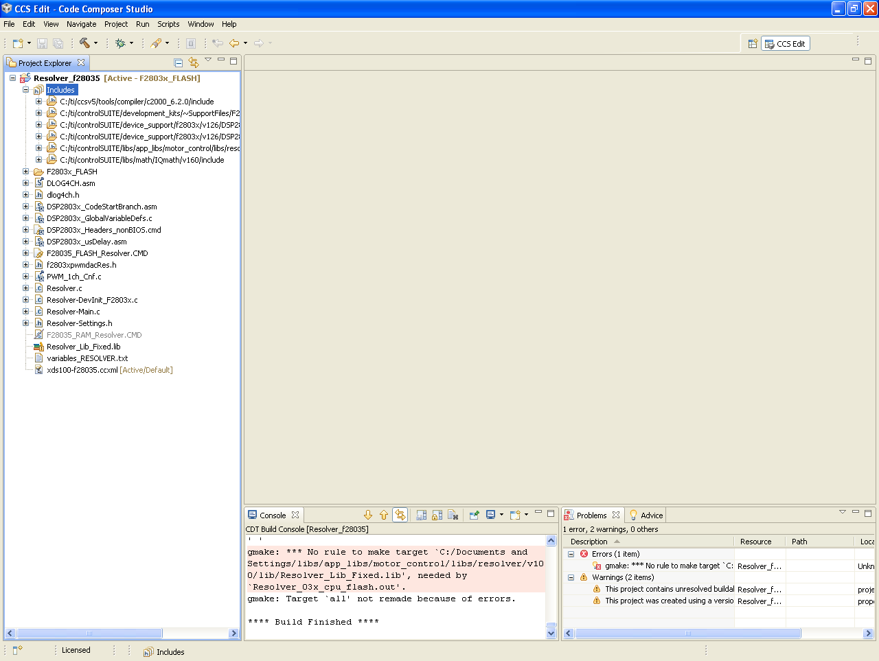

  • Ian,
    Can you post a picture of the project explorer view under CCS where it shows all the files..
    In particular expand to see if all the include paths are resolved.
    Also Can you try compiling the other projects i.e. Resolver_F28027 etc and see if they compile..
    Also attach the console output in a text file that shows the compile error

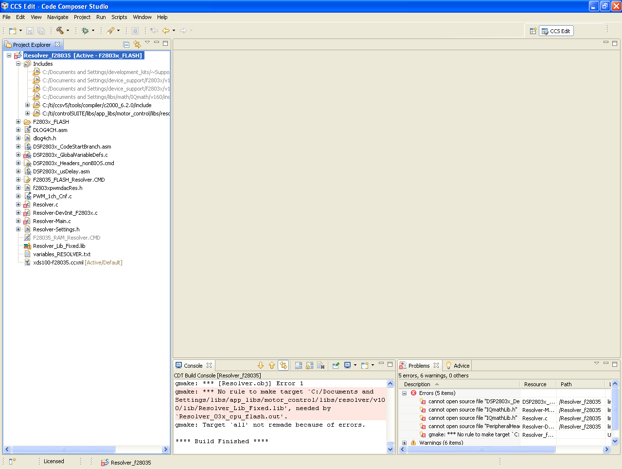

  • When I try to build the project straight out of the example page, I get 5 errors. 4 of them are because of invalid include paths. I have attached a screenshot of before I correct the paths and after. None of the other resolver projects will build either.
    Before:
    After:
    And here is the console output:

  • Ian,
    Can you right click on Resolver_Lib_Fixed.lib in the project explorer view, where it shows a question mark and delete it.
    Then right click on the project name -> go to add files  , now browse to the resolver library folder
    C:\ti\controlSUITE\libs\app_libs\motor_control\libs\resolver\v100\lib
    and add the .lib file, you can choose to copy or link the file..
    and see if it compiles then..
    The project looks to be setup correctly in controlSUITE, but i am still not sure why there are build errors on your machine.. ...

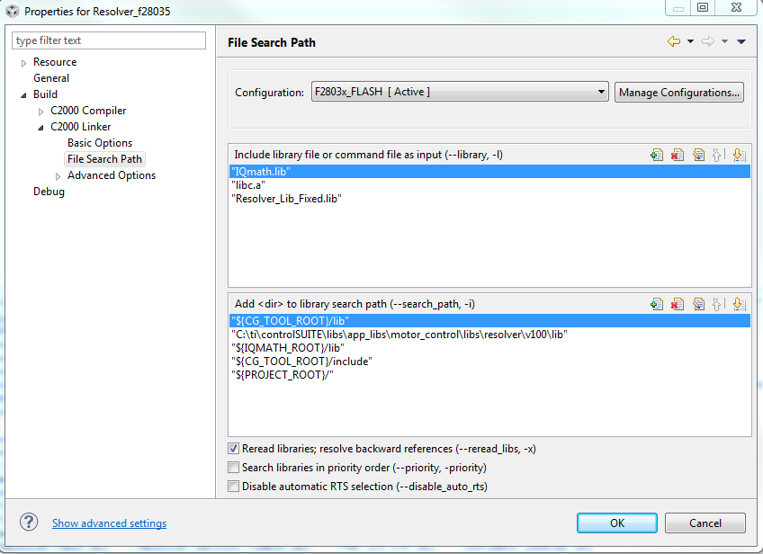

  • Ian,
    I think importing to CCS6 is one way, you cannot go back to CCS5, there will be issues.
    Are you using a clean project before you tried to import it in CCS6 when testing with CCS5.
    I have not tested with CCS6 but on CCS5 we are not seeing any issues and we have checked it on multiple machines..
    Also one more thing to try is to make the build options for linker and specify the library path explicitly
