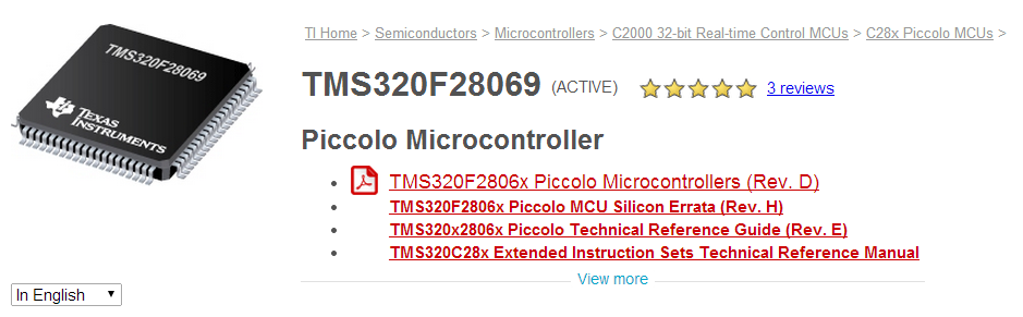

    3) Does this hold for the 2806x (this is the controlCard I am using with the HVLLC kit)?  I cannot find the errata for it => SPRZ342.  If I click on the link for this document at the bottom of the 28069 data sheet it says it cannot find the document.  The same goes for a link I found in a community post http://www.ti.com/lit/pdf/sprz342.  Or http://www.ti.com/product/tms320f28069.

  • Thanks Brett,
    Just one point of clarification.  This particular issue states affected revisions are 0, A, B.
    Piccolo is now on D.
    I take it this mean D no longer has this issue?
    Brent
  • What do you mean by "Piccolo is now on D"?
    As of today's date: F2806x is currently on RevB, F28035 is currently on RevA
    Thank you,
    Brett
  • Sorry my bad, I saw the following and incorrectly assumed it meant silicon rev
    Thanks again for your help,
    Brent
