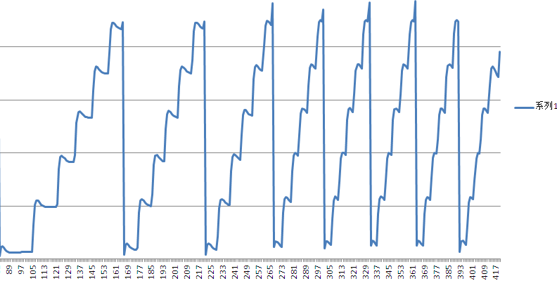

hi chris:
     I use the hall sensor on 28027f, but the angle output isn't good ,could you tell me more information about observer .c, I dont't know whitch  Parameter maybe influence the output angle , I usual  need a large load in motor start .

the angle:
  • xianmin,
    I suppose this is from the early release of the HALL based FOC project?  When I posted that I mentioned that it was UNSUPPORTED and is NOT AN OFFICIAL RELEASE.
    We have made some changes and are looking at including it as a MOTION PROJECT in one of the next releases. We will NOT support directly for the 27F -FOCprojects (though you could potentially port yourself).
    If I were you I would not try to run with Halls all the time. FAST will  give you a MUCH more accurate angle than halls ONCE the rotor is moving fast enough to guarantee operation.
    If you want to use HALL sensors to generate a first best guess to the angle, just do that. Get a starting angle, seed the estimator by settintg that angle, and then start up either with or w/o ForceAngle.  We actually find that DISABLING ForceAngle typically works better since FAST can take over so quickly.

    I see anything about hall sensor from this forum, but I forgot it's not the TI support. My project need large load in  motor start, and the sensorless can't meet our needs,so i need hall to start.
    I am glad hear the one of next releases maybe support hall sensor.
    I will try your suggestion use hall start and sensorless run.
