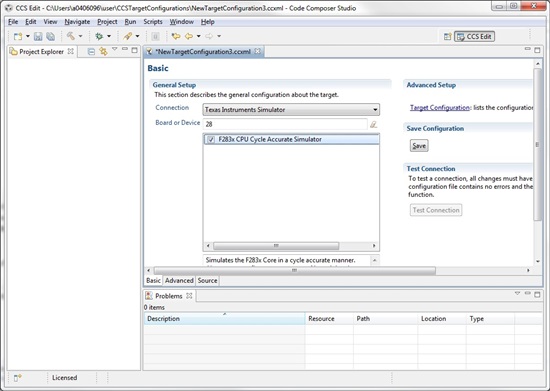

Do you know where I can find a simulator for this target to debug in CCS without the demoboard?
I only have choice for emulators in debug preference even if I installed everything with the CCS setup.

Hello Rachid,
You can find more information about CCS simulator here:
http://processors.wiki.ti.com/index.php/Category:Simulation
http://processors.wiki.ti.com/index.php/List_of_Simulator
Based on the list, F28069 is not supported for CCS simulation.
Maria
There are such point on the list "CCSv3.3 Core Simulators" - "F28x (for Tutorial)"
What this means?
