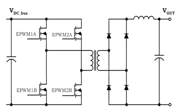

  • Hi Hrishi,
    Effectively we try to control a phase shifted full bridge power stage with the peak current mode control, but this shifted full-bridge is controlling the buck converter, like below:
    source: http://processors.wiki.ti.com/index.php/C2000_DPSWorkshop
    I try to determine our slop compensation problem, so I listened to the DPSWorkshop as recommended. After listening, I'm wondering if we made a hardware connection error, so is it essential that we use EPWMxA for top mosfet and EPWMxB for bottom mosfet, or is doesn't matter?
    In other hand, when I implement the slope compensation design, I have some an issue with what I observe in debug mode and what is really apply to the comparator negative input. I observe the RAMPSTS ramping down at each SYSCLK. How do I validate it?

  • Hi Hrishi,
    At this moment I think we find our problem. I previously said that I use the EPWM5 as the RAMPSOURCE PWM. After few tests my colleague determine that the EPWM5 must be shifted by the length of the blanking window. We try it and then I observe the deactivation of the PWM under the RAMPMAXREF value. So far I have not observed this phenomenon. I do not have the exact expected value when the PWM is shutdown by the comparator COMPSTS.
    So I wonder if my perception is correct, I think RAMPSTS register is decremented by the value of RAMPDECVAL register every cycle of the system clock (set to 60MHz), is this true?
  • Yes, after a PWMSYNC event the value of RAMPDECVAL_ACTIVE is subtracted from RAMPSTS on every SYSCLK.
  • Hi Hrishi,
    Effectively I confirm that I have a subtraction at each SYSCLK of the RAAMPSTS register with the value of the RAMPSDECVAL_ACTIVE register, my timing issues is directly links to the signal buffer plus the ADC hysteresis.
    Thank you very much for your help and also for Davis help!
