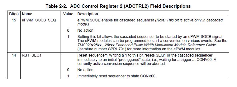

  • Dear Bill,
    I have 3 dual (i.e CONV9, CONV10, CONV11, total 6 ) signals that I have to simultaneous capture.
    Setting RST_SEQ1, (find attached) immediately resets sequencer to the initial CONV state.  If you see the description of RST_SEQ1 in SPRU812A, it says its waits for the trigger. Its not a trigger.
    I still tried it but it didn't trigger the SOC. I also checked the ADCST register. The SEQ1 is initiated but SOC of ADC doesn't take place, as the control never goes to the adc_isr in which I have a breakpoint.
    I am in-between trying the XINT2, I set the GPIOxINT2SEL register , set adc_isr to handel external interrupt  PIE group 5 and GPIOMUX register. Gave a 3.3V to GPIO31 as an external interrupt (similar to switching on a button) but the controller got disconnected from the IDE. I am just working on that how to give an external interrupt at the moment.
    Any other hints will be helpful.
    Pankaj
  • Dear Bill,
    I was able to solve my problem of the SOC trigger, I had commented the PIE line for the interrupt while testing for other conditions.
     PieCtrlRegs.PIEIER1.bit.INTx6 = 1; // ADCINT enable
    In the CPU_ISR I just wrote
     AdcRegs.ADCTRL2.bit.SOC_SEQ1 = 1 ;
    PieCtrlRegs.PIEACK.bit.ACK7 = 1;
    At the moment having trouble capturing the ADC values in Dual-Simultaneous mode. The code works fine for Sequential-Cascade mode.
    Pankaj
