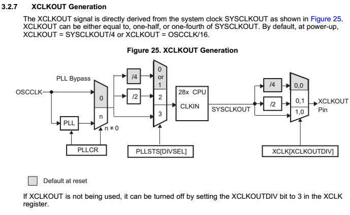

I'm programming a TMS320F28026 and am suspecting a wrong CPU configuration or calibration. I am setting the following:

I next suspected the CPU clock to be misconfigured. I wrote a loop like the following:
    while (1)
        ((GPIO_Obj *)handles.gpio)->GPACLEAR = (uint32_t)1 << GPIO_Number_16; /* set pin to zero */
        ADC_readResult(handles.adc, ADC_ResultNumber_3);
        /* last line is repeated 512 times */
        ((GPIO_Obj *)handles.gpio)->GPASET = (uint32_t)1 << GPIO_Number_16;   /* set pin to one */
The line that calls the ADC function (which is inline) is translated to:
    92DC          MOV       AL,*+XAR4[3]          ; [CPU_] |653|
in the assembly listing, so it's a single CPU instruction. In other words, I toggle a GPIO pin after 512 CPU instructions. Looking at the time difference between the pin toggles by an oscilloscope, I see about 68.80 microseconds of time. This means that each MOV instruction took about 134 nanoseconds. From a clock speed of 60MHz, I would have expected a speed of about 20 nanoseconds.
This, and the slow ADC conversion time, makes me suspicious that the CPU clock is not 60MHz, but something smaller. Perhaps that PLL setup failed to achieve the *12/2 operation on the 10MHz input clock? How can I be sure my CPU clock speed is set correctly?
Thank you,
Shahbaz
  • Shahbaz,
    The best way to confirm the CPU speed is to output the SYSCLK onto the XCLKOUT pin.
    -Tommy
  • I can confirm that the XCLKOUT using a divider of 1 gives a 60MHz output as expected.
    Do you have any other ideas where the slowness could come from? I see that the processor is pipelined with 8 stages. The 134 nanoseconds adds up assuming the 512 consecutive MOVs are not pipelined for whatever reason.
    However, the original problem with ADC still remains. If the input to the ADC is 60MHz and it needs to do four conversions in a chain, each taking 7 clock cycles, then generating an interrupt which simply acknowledges the interrupt and sets a flag, how does that take 7 microseconds?!
    Is there a way to check more precisely how long the ADC works?

  • Shahbaz,
    One thing to keep in mind here is that the ACQPS value is only the S/H stage.  An additional 13 ADC clocks are required to convert the S/H voltage into a digital value.
    Settings in the ADCCTL2 register can also vary the ADC timings.  You can refer to the timing diagrams in the datasheet or ADC reference guide for this.
    -Tommy
  • Are you executing out of RAM or FLASH?
  • Thanks for the hints.
    Actually you are right, I'm executing from Flash. I changed the title of the discussion to better reflect the content.
    Speaking of RAM, I had done the following (in the very least, for DSP28x_usDelay (from DELAY_US), which executes from RAM):

    I'm using the f28026.cmd file from the control suite (version 210). The runtime support library is selected automatically by code composer. I'm also linking to f2802x_common/lib/driverlib.lib from the control suite.
    Following the assembly, the problem is in FLASH_setup, which in turn calls FLASH_setStandbyWaitCount, which ends up at the marked point (giving a bit of context too):
                FLASH_setup, RamfuncsRunStart:
    008000:   49D5        TBIT         *+XAR5[2], #0x9
    008001:   6544        SB           68, LEQ
    326         FLASH_setStandbyWaitCount(flashHandle, 0x01FF);
    008002:   D7D2        MOVB         AR7, #0xd2
    008003:   78E2        MOV          *+XAR2[4], AR0
    008004:   5539        CMP          AH, @0x39
    008005:   6082        SB           -126, NEQ       <<<---------- OFFENDING INSTRUCTION
    328         FLASH_setActiveWaitCount(flashHandle, 0x01FF);
    End result is that the marked SB instruction jumps to a part of memory that is not mapped anywhere (address 007f87, which is 126 bytes before). It seems like it's trying to jump somewhere outside the function!
    Do you have any idea why? Am I configuring something incorrectly? Should I be using a different linker file, or link to a different library? Should I recompile the whole control suite library myself, so it would conform to my settings?
    Thank you for the continued support

  • For future reference, I found my error:
    On my line:
    memcpy((void *)RamfuncsRunStart, (void *)RamfuncsLoadStart, RamfuncsLoadEnd-RamfuncsLoadEnd);
    Besides the fact that I should have done End-Start rather than End-End, I should have used the address of those variables, rather than their value, because the linker file binds those symbols to the first byte of the copy sections. I was under the impression that the linker binds them to the address of those locations. In other words:
    memcpy(&RamfuncsRunStart, &RamfuncsLoadStart, &RamfuncsLoadEnd - &RamfuncsLoadStart);
  • Glad to hear that you traced down the culprit.
