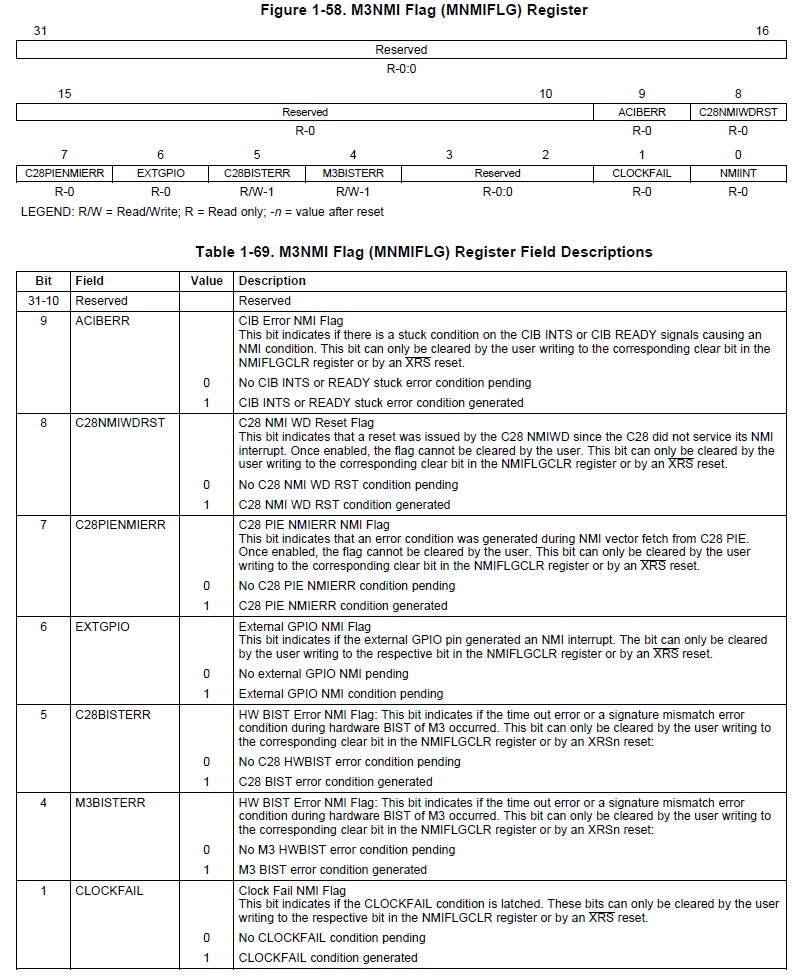

Please teach me "Voltage Regulator warning NMI".  TRM(spruh22f)
I do not know the details of this.
Details of this is not described in TRM.
It is described as follows others.
"Voltage Regulator warning NMI" does not exist?
