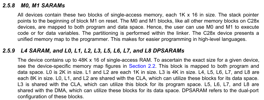

    OZGUR POLAT said:
    I assign RAML4 for .cinit
    OZGUR POLAT said:
    But I'm not sure that assigning RAML4 to .cinit is good or not ?
    Based on datasheet of F28069, you can do it.
    If you use flash, you can put your .cinit in flash.
    So I think your problem is solved, right? Please verify the thread to mark it as solved.
    Cheers!
    Maria
  • Thanks Maria, the problem was solved !
