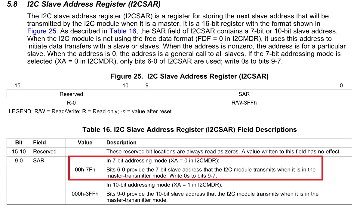

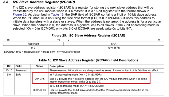

         I am doing the interface of 24C08b i.e. eeprom with F28069 I2c_eeeprom.The Read operation is not working.While debugging in  watch window I got the msg status of read structure is toggle between 0x21 &0x20;
Can anybody tell me where is the problem.
    Are you using the example from ControlSuite? Any modification?
    This chip needs 5V supply, do you connect it correctly?
    You can send your code here so we can help you to review it.
    Maria
    Thanks for the reply.
    I am using example of ControlSuite (V110 & V115).
    Only Slave address was changed to 0xA0 as per the datasheet of 24C08B.(A2,A1,A0 connected to the ground)
    I am giving 5V supply to the Chip.
    Please check the datasheet about I2CSAR.
    So I2CSAR should be 0101 0000 (0x50), not 0xA0 (bit read/write is not included in I2CSAR).
    Maria
