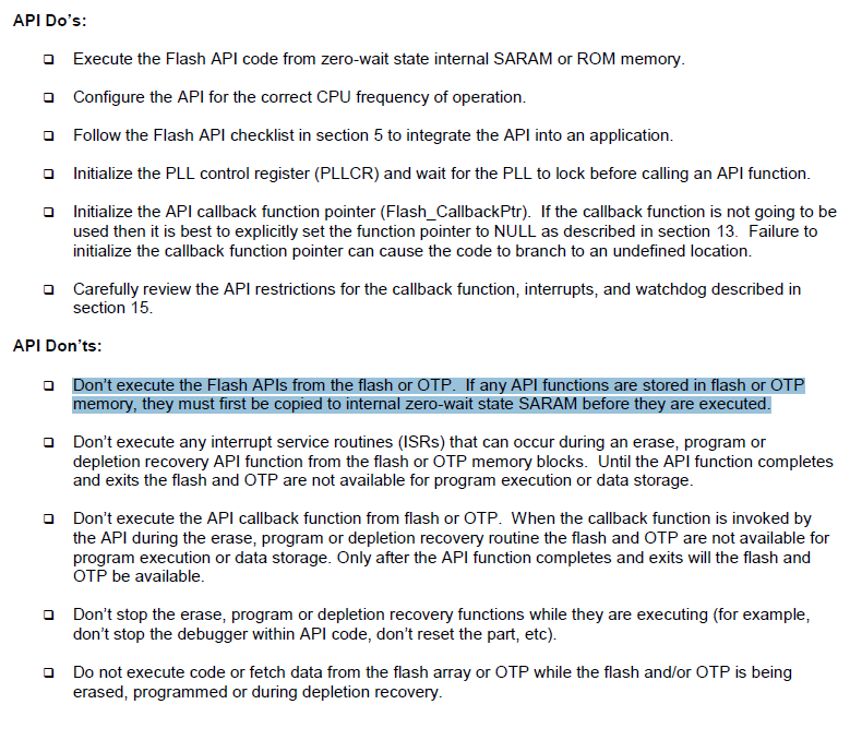

    1. Address location 0x3FF4FA corresponds to wait_boot function in BOOT ROM. You shouldn't get to this function unless there is a device reset (may be watchdog reset).
    2. Different ways you can get into wait boot after a device reset
      1. With JTAG connected:
          1. if EMU_KEY register, 0xD00 is not equal to 0x55AA
          2. if EMU_KEY register, 0xD00 = 0x55AA and EMU_BMODE register, 0xD01 = 0x2
      2. With JTAG disconnected:
          1. GPIO37 = 1 and GPIO34 = 0
    3. I checked Flash_erase function in API, within the Flash_erase() we do disable the watchdog. So, I don't think Flash_erase() is one re-enabling watchdog.
    4. I'm wondering whether CPU is reading an illegal opcode, as reading illegal opcode would trigger ITRAPIsr which inturn enables WD causing WD resets. Have you already checked this?
      1. if PIE enabled, 0xD26 should point the ITRAPIsr function address
      2. if PIE disabled, 0x3FF781 should point the ITRAPIsr function address
    5. Hope the customer is running all flash related algorithm from RAM. If you check the example flash API project, we run all the flash related algorithm from RAM after using Example_MemCopy function. You CAN'T run flash algorithm from flash. Even this might cause illegal instruction fetch.
    6. Please make sure your code follows these guidelines.

    My understanding (confirmed in the product litterature) was that the FLASH APIs in the F28069M devices is in ROM not FLASH, therefore not requiring them to be transfered to and run from RAM.  There is even a comment refering to this within the example code project.  Is this not the case?  What is actually required to be run from RAM in these devices?
    Stuart
  • Stuart,
    Please check the flash api example. In that example, Example_CallFlashAPI() function which inturn calls Flash_erase, Flash_program (or) any flash API function should be run from RAM. This Example_CallFlashAPI() function is loaded in FLASHA but run from PRAML0.
    Manoj
